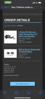

Some background; My tow vehicle is a 2017 JKUR (max tow capacity 3500lbs). I wanted an aluminum trailer (lighter and less corrosion) that I could convert into an overlanding platform and make upgrades/modifications as my resources would allow. Basic planned configuration was rooftop tent on top of a rack secured to the trailer with the existing rivnuts and a weather tight tongue box for future electrics etc.
I decided on the M1101/1102 trailer and found a local fabricator that could do the major modifications to the trailer.
After towing the trailer in its stock configuration for a bit I decided to change a few things;
1. I wanted it to be the same width (or slightly smaller) than the Jeep. This is the major mod to the trailer.
2. I wanted to swap the suspension for an axle-less suspension. I went with a Timbren 2200lb suspension with long spindles and 4”lift (more on this later)
3. I wanted a three axis hitch on an extended tongue and electric brakes, and I went with dexter hubs that fit the suspension but also allowed me to run the same wheels/tires as the Jeep.
