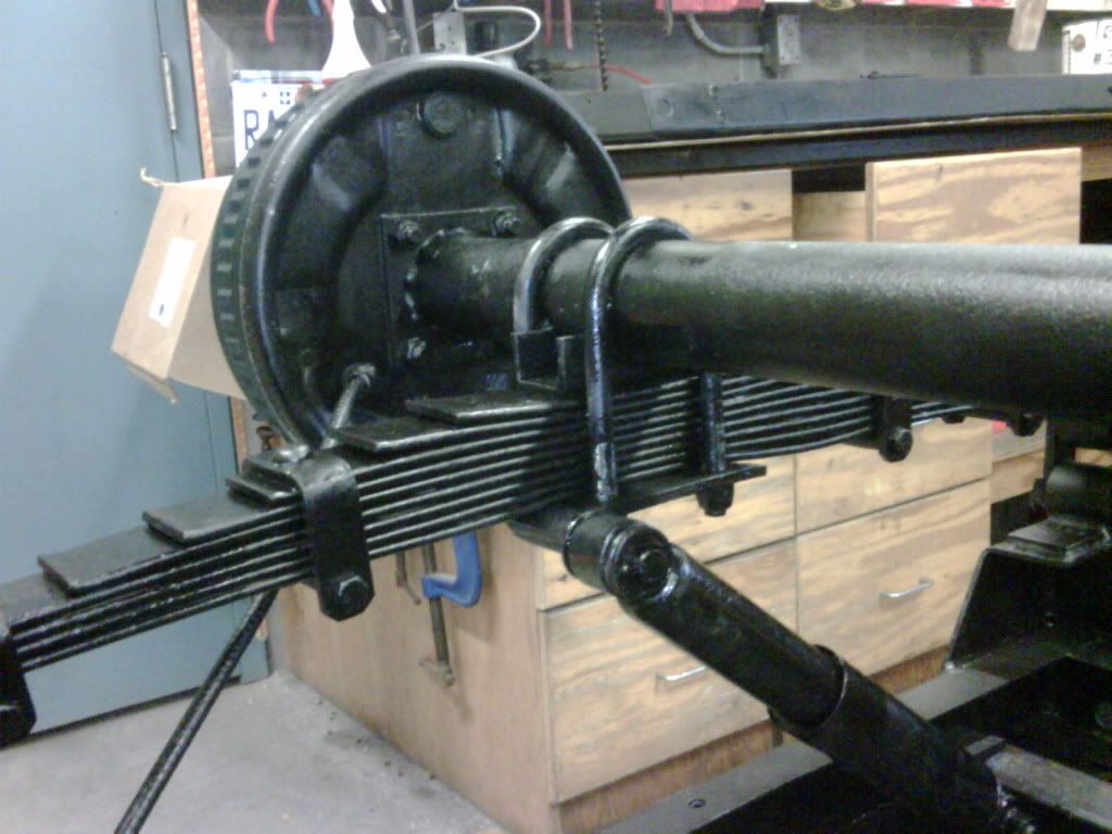

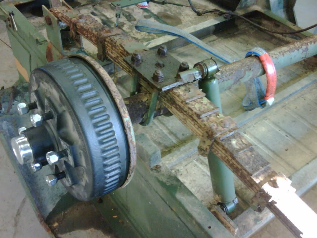

Mekinac Observer Nov 23, 2008 #5 MoGas said: Won't they be too long and bottom out? Click to expand... No, but you must flip the shock mount side to side and upside down. Before After
