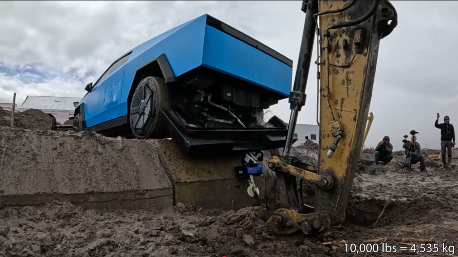

According to these two interesting and enlightening stories, the decision to use cast aluminum for the frame on your vehicle that supports your towing infrastructure might not be the best idea.
cricketwagon
Do you fly places for business or pleasure ? Aren't you concerned that the air frame is made out of aluminum and is exposed to significant stresses like turbulence ?
In all seriousness, what's the maximum dynamic load that a properly setup 11k trailer is going to put on the hitch receiver ?

In all seriousness, there are adhesives used even in the aerospace industry. When the correct compounds are used in the right context they can perform just as good as the mechanical fasteners while reducing complexity and weight.
cranecamsou
Just a guess here, don't shoot me....
11k lbs trailer, should be ~20% tongue weight. Let's say there should be some built in allowances for owners getting this wrong, so let's say 30% is within reason.
11,000 * 30% = 3,300 lbs static load
I would estimate dynamic loads on the highway, potholes, dips, speedbumps, etc could be 3x the static load pretty frequently.
3,300 static * 3 = 9,900 lbs dynamic. So yeah, the subframe breaking off at 10k Lbs seems like a major issue
I think it's an incredibly bad idea but we're missing the point here. Look at that hideous blue contraption. Isn't the idiot that designed it all about culling from the herd all that isn't the right color or doesn't look right to him and his.......people? I think Cybertrucks should be deported, no matter what work they can or can't do, because they don't look right.

I might be just an unfrozen caveman lawyer, but are airframes forged aluminum vs this cast aluminum?
ThundahBeagle
Well-known member
I thought tongue weight was supposed to be 10%? 15 maybe?
