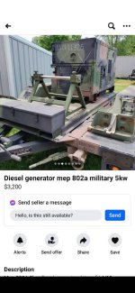

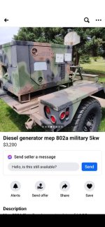

This is what it would have looked like stock from Shutt and what the military would have had. Screenshot_20240704-073659.jpgScreenshot_20240704-073715.jpg
