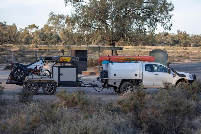

I saw this example of a trailer similar to what I'd like to build while I was Googling around for ideas. For anyone that didn't understand my crude drawing.
I don't think I'd do a dual axle set up though. 3500lb single axle should be okay; budgeting 1000lbs for trailer, 1000lbs for camping stuff, 700lbs for toy, still leaves me 800lbs under axle weight. I guess if I'm loading up with lots of water and spare fuel for a long trip I might need a little more capacity.. but I do have the back of the Tacoma for cargo too. I don't think I'd want to tow more than 3000lbs anyway.. no problem on the highway, but that's an awfully big land anchor in the mud. The trailer cargo will be mostly just a simple kitchen and some electrical for lighting and running the kitchen; the stuff that I don't want to permanently plumb into the tow vehicle.

I would recommend building from scratch. I have a few ideas not already mentioned. If getting anywhere close to 3500lbs and using off road I would move to a 5k axle particularly if you want to use oversized tires. It may not look as cool but you could get your desired track width and make the deck wider in front and/or behind the tire, there is no actual rule that the bed has to be inside the wheelwells. For the snowmobile you could build a couple of trailer hitch receivers into the rear of the trailer and slide an extension into them to lengthen the bed when using the snowmobile. Think it as one of those hitch haulers but with 2 or 3 hitches. Around here tube frames tend to rust from the inside out. I would recommend using C channel and angle iron and minimizing tubing. Tubing is also a lot more expensive. I am a leaf spring guy, and for a trailer used off road would recommend longer than trailer leaf springs. Look for something off a vehicle that has about a 3000 to 3500 GAWR . Something like your Tacoma springs from craigslist or junkyard would probably be ideal

For me the consideration for tandem axles is less about weight and more about safety. The two primary areas are with blowouts on the highway and improved departure angles. For the first, if you will be doing a lot of highway miles going to your destination then a tandem would be valuable. A blowout on a single axle can be catastrophic. For departure angles it would be beneficial if you are doing a lot of off-roading with significant drops. For these two reasons I bought a tandem. Fortunately I haven't had a blowout to worry about but have used the improved clearance many times.
