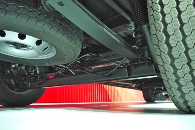

Testing electrical system, magnum2812 runs the 13500 AC easily plus I can run my hot water heater and microwave at the same time. The solar panels are cranking out amps, the dinette bed configure works out great as you can leave half the bed made and still use the dinette and table. The sound/insulation works great, very quiet even when the generator in running. Shown is the electric toilet 12v. Added air bags in the back as the generator was at 8 1/2" clearance after all the stuff I installed, now its what ever I need it to be. Still have to hook up the CB,Marine radio,scanner,wifi and cell booster.IMG_2316.JPGIMG_2321.JPGIMG_2323.JPGIMG_2320.JPG
