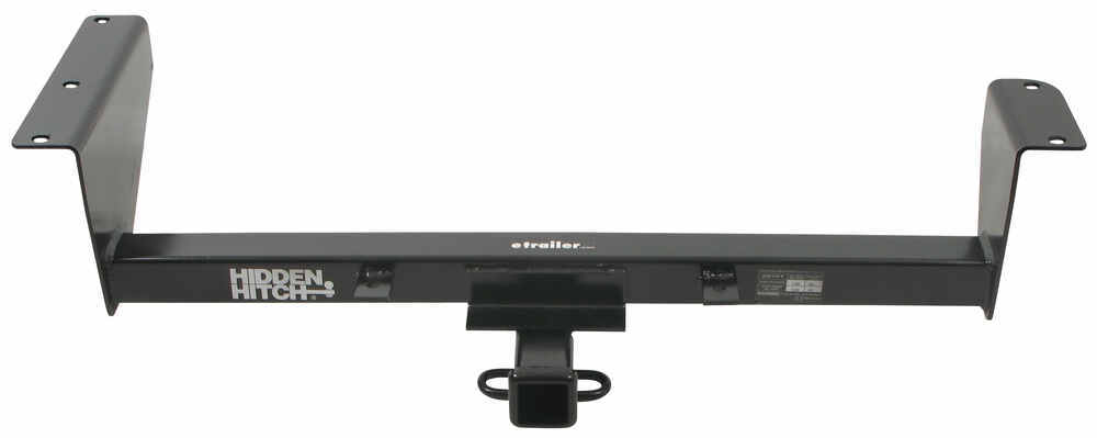

James although there are some class 2 hitches that only attach to the middle mounting area most are typically class 3 hitches like this one that attach to the frame.
