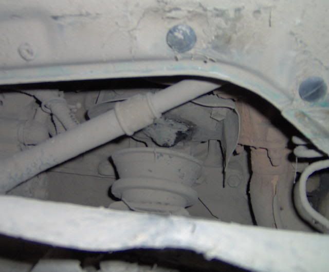

Yeah I changed mine on my Hardbody with a 3.0 v6. Just a matter of using a jack in the right place and sliding it out. The mounts are known to fail during hard offroad use. The left side (drivers side mount) is the most common to fail as the rubber separates from the metal. Both sides use the same mount so if your pulling them from a used truck pull a passenger side mount as they are under less stress.
Here is what a failed mount looks like. Access is easiest thru fender.
I welded on a little chain to my new mount to prevent it from being overstressed and ripping again.
Rock Humper fabrication also offers upgraded poly mounts.
