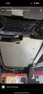

Underbody...
A big concern I had was the the vehicle traction battery (EV battery pack) being so vulnerable. ASFIR makes a skid plate for the front but no one made a battery skid plate for the Outlander. In fact from my research no one makes skid plates for PHEVs in general, even the Rav4 Prime has an exposed battery pack. The battery on the PHEV has a coating to protect it from light debris but the coolant hoses for the HVAC, and battery warming are completely exposed. I was able to get that solved as Road Race Engineering just happen to have the skid plates from the Outlander PHEV from the Rebelle Rally. A few instagram DMs and a few days later I had them installed! Road Race Engineering designed these as a request by Mitsubishi Motors North America for the Outlander PHEV that participated in the Rebelle Rally. They are made of aluminum and also featured a bent design to keep the single catalytic converter cool mimicking the OEM fiberglass skid plate.
![IMG_5624.JPG IMG_5624.JPG](https://expeditionportal.com/forum/data/attachments/741/741466-04370388a849d70aaf5b0022f8bebd0d.jpg)
![IMG_5620.PNG IMG_5620.PNG](https://expeditionportal.com/forum/data/attachments/741/741468-9cdc20044dd30d8975470d5fe230ff49.jpg)
