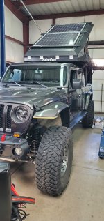

I have a Gladiator with a Canopy Camper that has solar so cannot mount antenna's on it.
I don't want door, bumper or hood mounts.
So here is what I'm doing.
Trailrax roof rack Front Half - for the Alu-Cab Canopy Camper.
Making a .125" x 53.375" x 23" Aluminum plate that will attach to the top of the rack giving me as much ground plane area as I can get.
GMRS Midland MXT 575 paired to a Laird TE Connectivity BB4502N
Kenwood TM-71A 2m/70cm to a Larson NMO-2/70SM I'd like to find a equivalent one in black?
Thanks.
