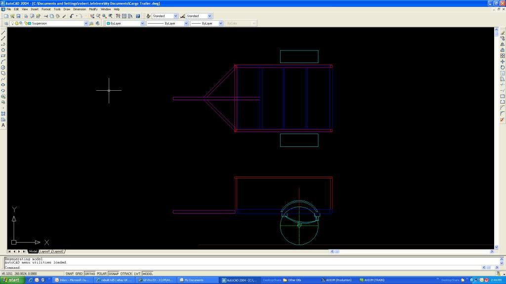

It sounds to me like you have similar requirements to the second trailer I want to build. Might I suggest you consider a 50"x72" box with 24" wall height. Make the tailgate full width, and support it with cables just like a pickup truck. Then when you want to carry 8' building materials, drop the gate and leave it hanging flat with the floor. Just like a pickup truck.
I have Autocad drawings already...
For leaf springs, maybe just look for Jeep leaves? Maybe even say... from a CJ7? Suggest comparing the rear axle load rating of the Jeep to your intended maximum trailer weight, see if you can get a match.
Oh, and I'd love to see those drawings, so far I have some very rough sketches of the frame and front platform/tongue structure I did while was at work, while I was supposed to be... well, working... :coffeedrink:

Not complete, but here you go:
I set the axle well back so that it balances in 4x8 mode. The tongue weight will be high, but no huge deal for typical camping loads. Only problem would be if hauling dirt or firewood in the 4x6 mode.
One could even do like a "bed extender" just like a pickup as well. Just saying, an 8' trailer is really big for offroading. (yeah, like I should talk...)
From my experience... I *have* a 4x8 trailer right now, and I use it a lot. However, if I had the time, I'd build the 4x6 and sell the 4x8.
