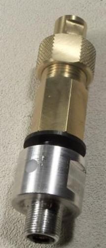

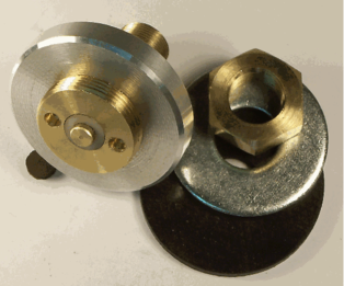

I use Teraflex tail light antenna brackets on my LJ - CB on driver's side and ham on passenger side.
The two antennas that consistently give me the best results are my Larsen NMO 2/70B and the shorter Larsen NMO 2/70SH.
Ham - Teraflex tail light antenna bracket with Breedlove NMO mount, Larsen NMO 2/70SH antenna shown.
https://breedlovemounts.com/store/ols/products/nmo-trunk-mount
rs=w:600,h:600
CB - Teraflex antenna bracket with Breedlove stud mount and all brass disconnect , 2' Firestik II antenna shown. Alternate antenna is a 4' Firestik Firefly.
https://breedlovemounts.com/store/ols/products/stud-mount
rs=w:600,h:600
The brass quick disconnect I am using for my CB antenna is no longer available, but Breedlove now offers a quick disconnect mount that I like even more.
https://breedlovemounts.com/store/ols/products/quick-disconnect-mount-w-ring-terminal
rs=w:600,h:600
https://breedlovemounts.com/store/ols/products/quick-disconnect-mount-w-so-239
rs=w:600,h:600
