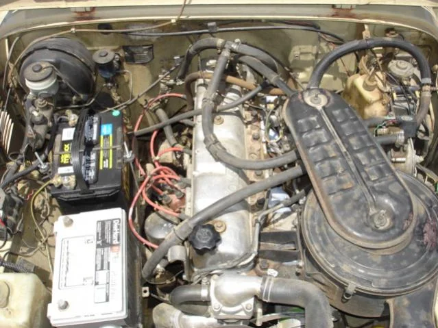

We need a picture of a right hand drive FJ40 2f Engine Compartment - can anyone help?
EDIT: We are working on a RHD power steering conversion and need to know if the pump placement will interfere with anything different than the LHD US models we have everything for.

From my old FJ45 Troopy:
HTH

BTW...I ended up getting everything for a PS conversion out of OZ...not cheap, I think it ran me about $800 US including shipping.
This was using the toyota ps design, rather than saginaw.
Here are some pics of a LHD PS pump mount for a Toyota...RHD is just reversed to mount to the frame in "mirror" style.

What pump mount are you using? I've done RHD kits using all of the same LHD components with the exception of box and hoses, even the conversion drag link will work with the appropriate ends.

I was going to make my own pump mount using the reverse of the bracket in my pics...
Scott...did you end up doing the install on the Troopy using the 3FE bracket?

Yes, BUT steering box not yet in. Troopy is on display at Camelback Toyota and I'm planning on tackling that in the deep hot summer :)

Thanks for the info guys - we do an FJ60 box and Saginaw pump setup with out own custom bracket, and we already had a RHD 60 rebuilt box so that part was easy, we just want to make sure the pump being mounted in the same spot wouldnt be an issue.
