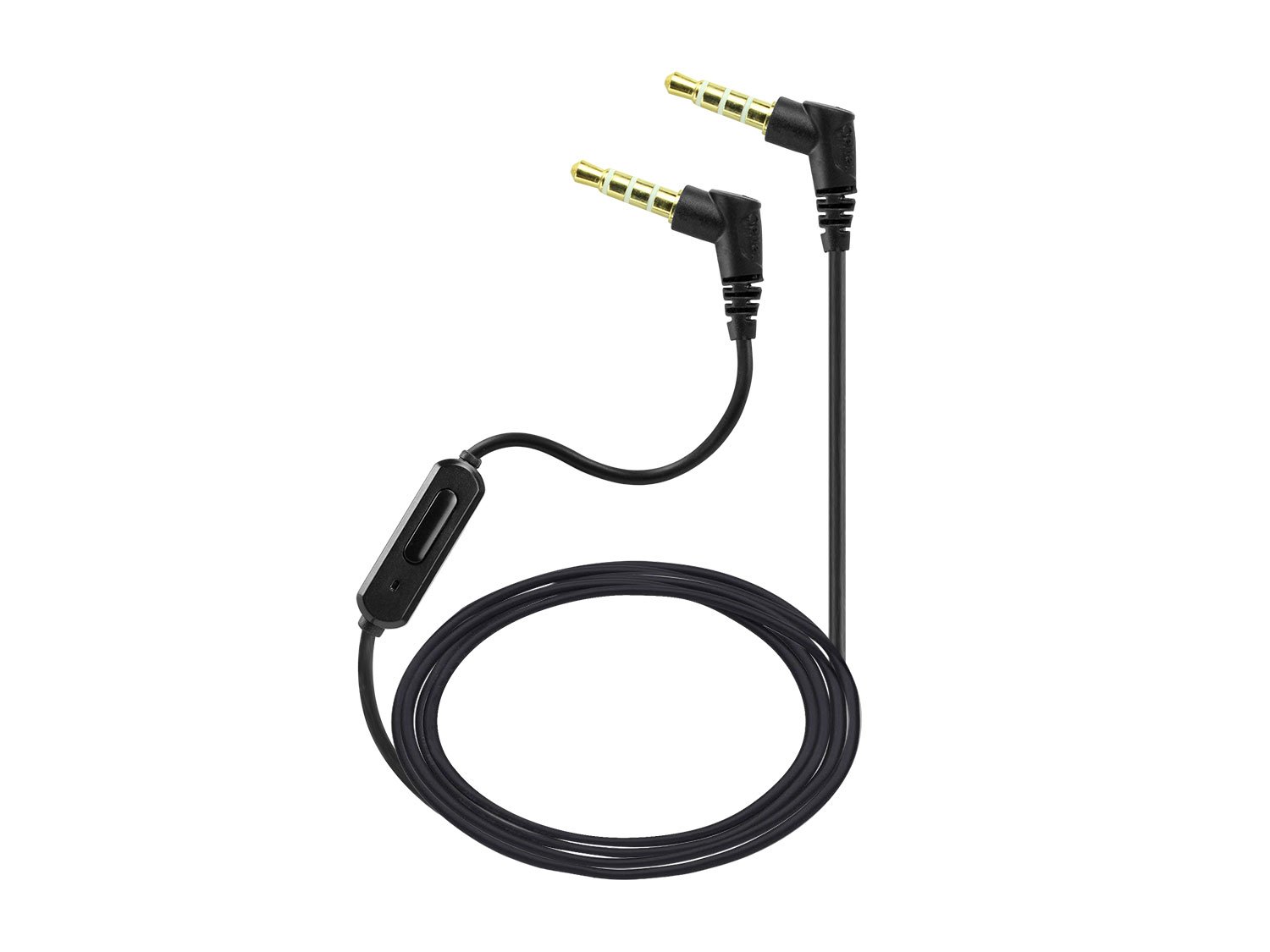

If what you want to do is use the headphones for listening, and a separate hand held microphone, I'm pretty sure you can do that. I think yaesu makes a Y adapter that splits out the 4 conductor 3.5mm from the radio into two 3.5mm sockets, one for microphone and one for headset. You'd still need a separate microphone if you didn't want to talk into the radio's built in microphone.
Or you could buy a 4 conductor 3.5mm plug and wire up your own adapter.

It's amazing what you can find on Amazon!
http://www.amazon.com/Cellet-3-5mm-...eywords=3.5mm+to+3.5mm+with+inline+microphone

So I called Howard Leight to double check with a tech that I can use the male to male cable with inline microphone to do what I want and the tech said no.
I said why, she said because the product is not designed for that.
I explained how it should work and she agreed that it should work in theory but that they do not recommend it because the headphones (with audio jack) are not designed to be used as a communication devise, only for listening to music. I suggested it is the same thing to listen to music or a voice from a handheld and use an external microphone to communicate and she agreed but did not recommend it.
.....it's too bad sometimes when the fear of liability limits a manufacturer from embracing the full potential of their product.
Hopefully this idea of the male to male cable with inline mic will work, not sure yet.

If it doesn't work w/ the special cable, I'm positive there is a way to wire one up. Digikey has the 4 conductor plugs.
rayra
Should be a real simple matter to wire one up out of a cellphone headset / mic and a new plug connector.
The amazon piece should work fine.
I'm using a straight 3-conductor adapter cable for podcast playback from my iPhone to my same Howard Leight electronic earmuffs, works great. And I'm able to take a call, hear the conversation thru my headphones, while speaking into the phone mic as normal. I just take the call with the phone in my shirt pocket, mic end up. Don't know why that works, but it does, just tested that to be sure. maybe because the cable I'm using has no mic component. I'm not sure but I ***-u-me that plugging a headset with mic into the jack on the phone would disable the internal mic(?)
That might not work in a high noise environment, from the other end of the call, but that would be the case whatever regular microphone solution is used. You'd have to be using a throat / induction mic to beat that aspect of it.
