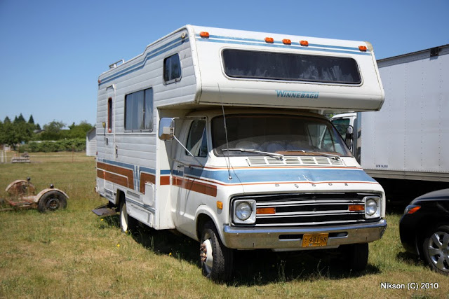

but here is what I bought for $1000...

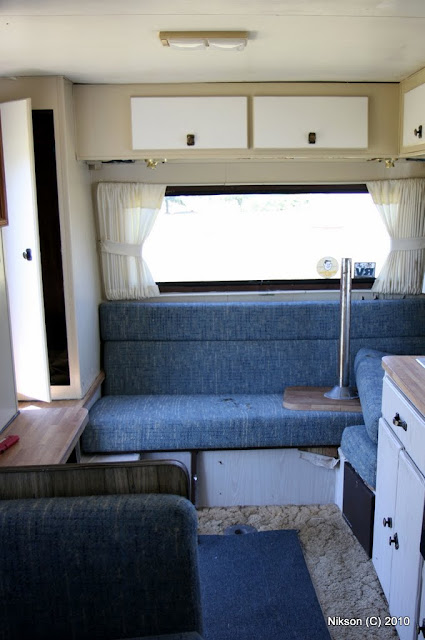

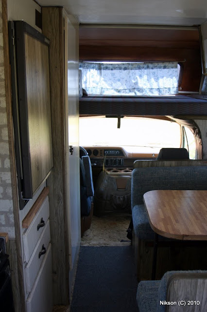

1978 Dodge Minnie Winnie 20' RV
about 80k mileage
Here what I've done...

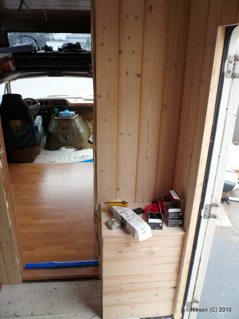

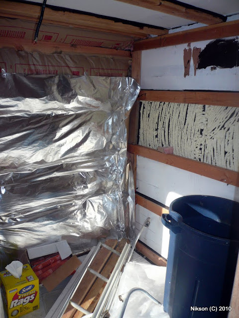

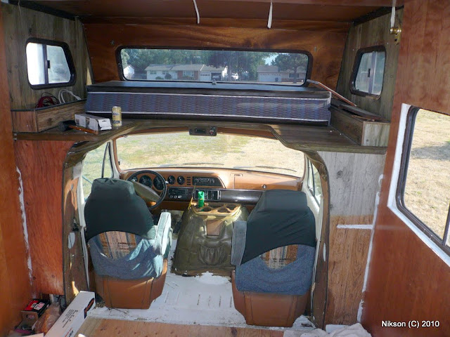

Pre-Sauna Room

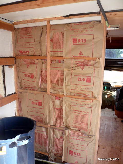

Ripped everything out... got over 1000 lbs of junk out of the RV...
Cabinets, furniture, appliances...
Ones had the "naked" walls, wrapped up the front section with 1" foam sheet (ones used in EFIS STUCCO) and covered it up with 1/4" cherry veneer...

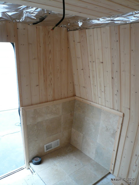

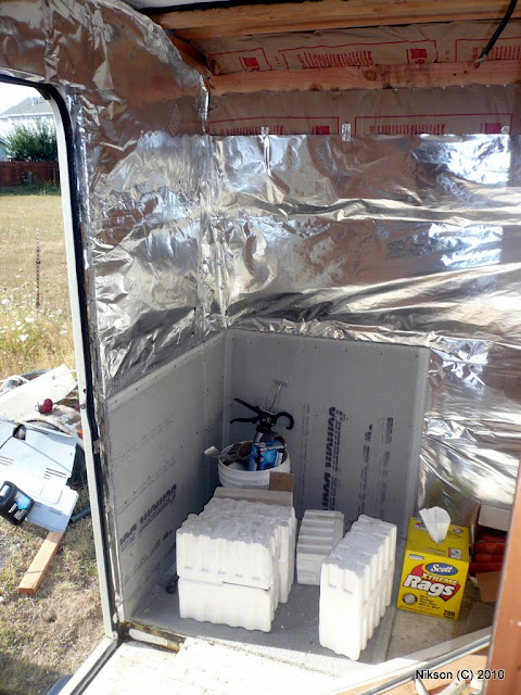

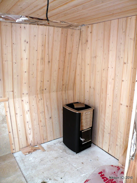

SAUNA section...
2x4 framing... proper insulation... and heat protection for a wood-burning stove...
(yes., everything by fire code)...
FYI: after over 12 months use, no issues... (for those who might be worried about this "thing" burning down)
SAUNA SECTION

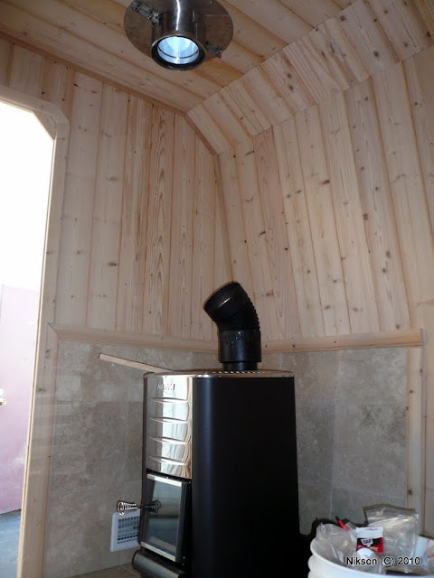

WOOD BURNING STOVE "CORNER"
DUROCK ready for travertine style tile...
WALL DIVIDING SAUNA from Pre-Sauna Room

STOVE corner... (tile done)

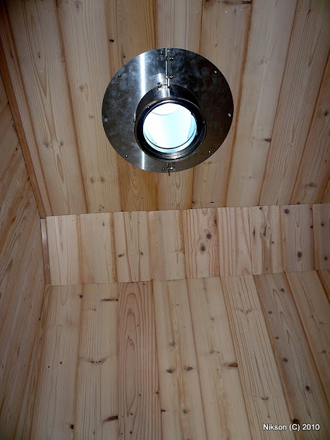

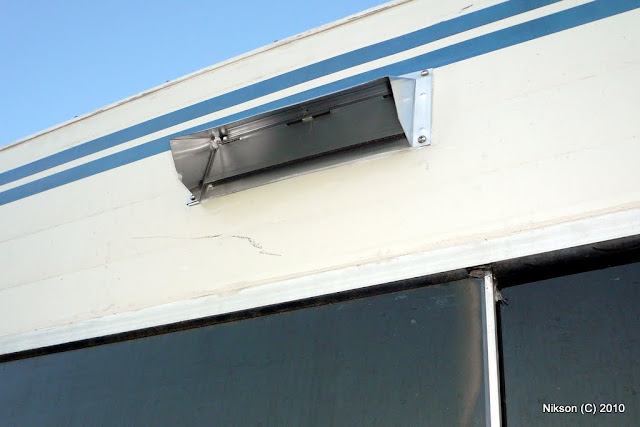

UPPER VENTILATION

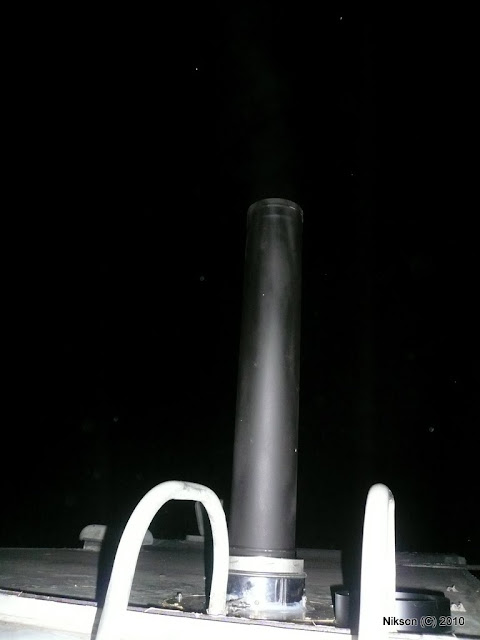

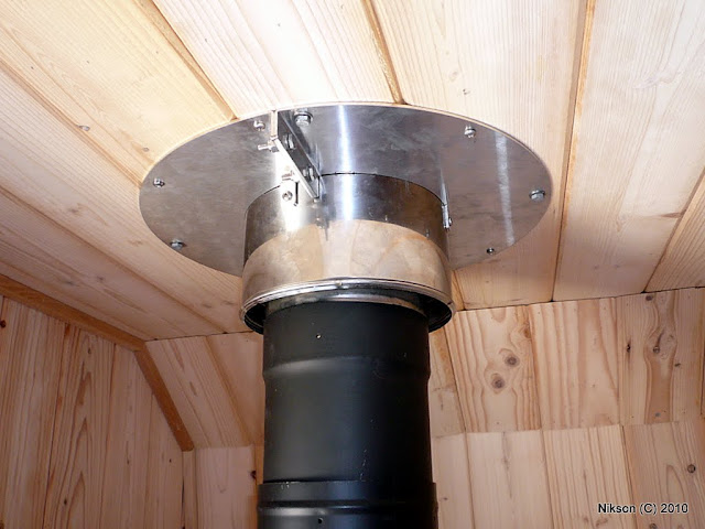

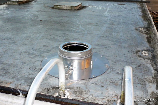

UPPER CHIMNEY... and other...
here is a shot of the upper chimney with stainless steel 12" piece.
custom laser cut brackets (outside/inside)
EXTERIOR
INTERIOR
STOVE IN PLACE

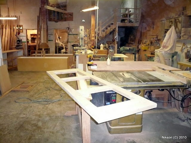

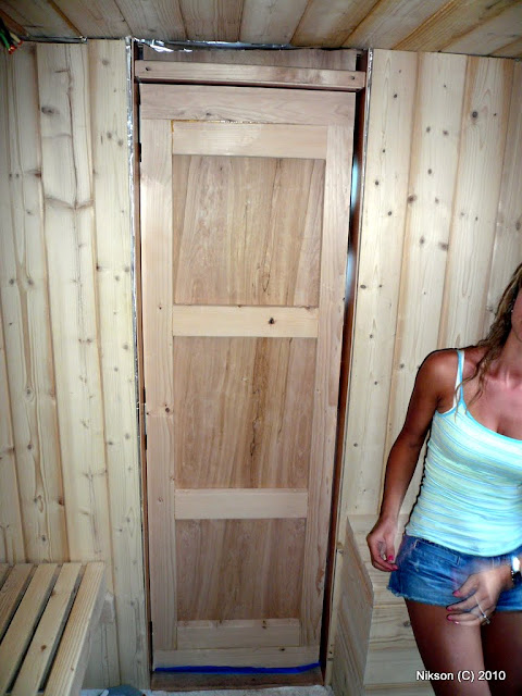

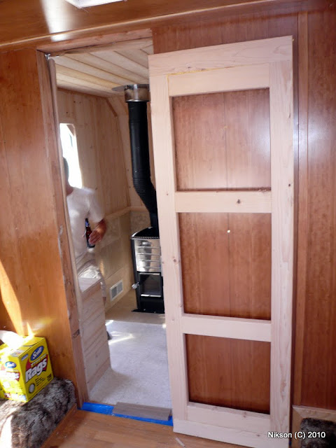

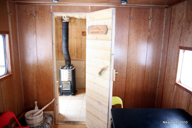

Sectional DOOR
here is door in progress...
Door in place...
Interior is done...
Door view from SAUNA's side...

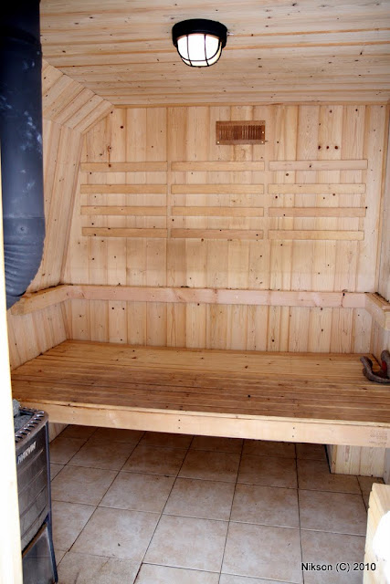

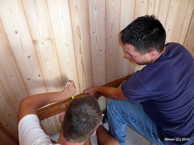

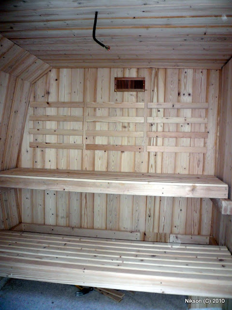

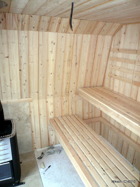

Bench work...
Benches are next...
Process is simple... getting the most use out of the RV space available...
Sleeping space is considered at the most...
2 can sleep in the overcab space
2 can sleep on the floor (air mattress or similar) in the pre-sauna section
2 can sleep on the benches in sauna itself (considering its not HOT :) )
One step at a time...
So, what do you think??? LOL
This picture shows how bottom part is set up. Upper bench is made to be lowered for sleeping next to the bottom bench. A 6' guy has no issues with fitting in.. (I am 5'10" and fit in comfortably)

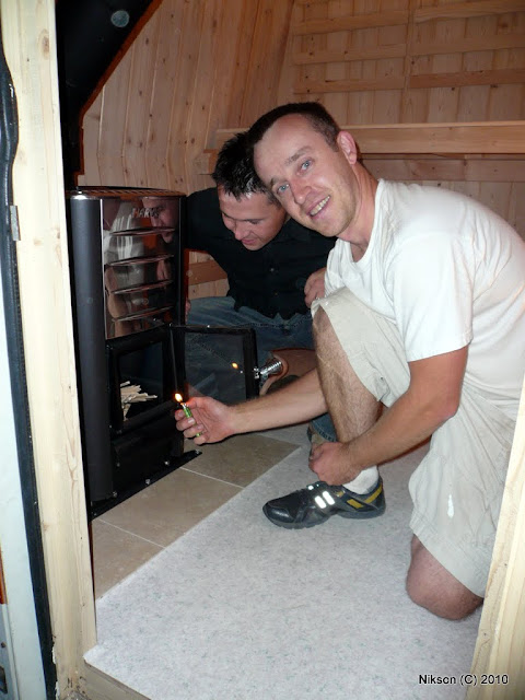

First impression...
Great feeling it is... when everything works out as you plan... :)

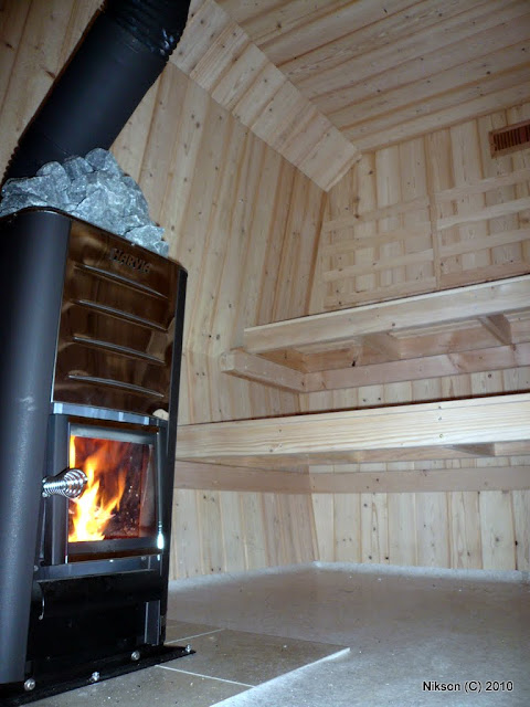

Here is a picture of the first "fire UP" so to speak.
Chimney worked out great without any issues... no smoke leaks, ventilation is well...
Rocks piled up... bring on that WATER... :) :) :)
Top chimney section (mushroom on top isnt installed yet)

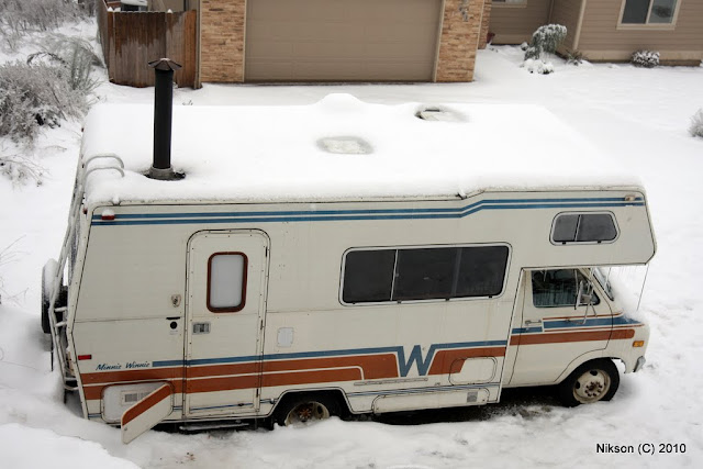

Winter of 2008
Had pretty fun 2 weeks around Christmas time. Snow that Willamette Valley hasnt seen for some time...
You can get a feeling what it was like having this thing in real snow...

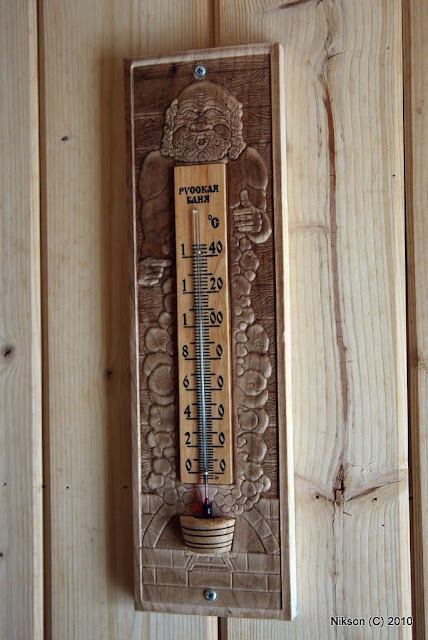

HERE ARE SOME INTERIOR DECOR pieces...
(hand carved)
GOTTA have clock w/ all the HUMIDITY & TEMP gauges...
