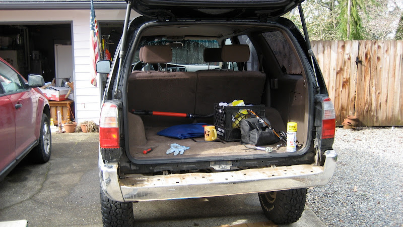

First step: collect underwear.
Step Two: .... .........

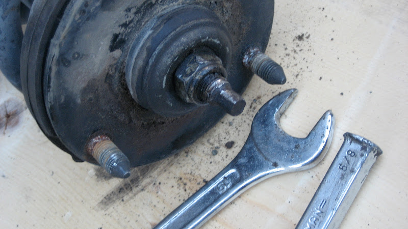

So once I figured out the pressing down on the upper control arm part I had the stock coilovers out and discovered that the stud was corroded to nothing and I couldn't get a grip on anything. It squirted out of the vice even!
So once I figured out that the top plates weren't going to come off in a conventional manner, out came the sawzall!
Problem solved!

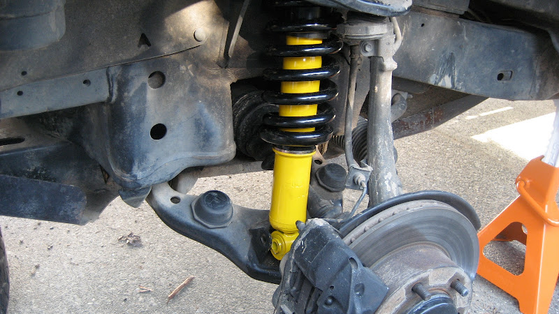

When I put the 882's on the Autozone spring compressors they started to become angry way before they were anywhere close to where they needed to be to get the top plates on. So I made a few phone calls and found a local shop just down the road that said they could get to them sometime this morning. I jammed down there and got there just as most of the guys were starting work. I talked to a couple of guys that were standing around and they weren't too sure if they could even compress the springs. The manager came in the shop and took over, he had the springs together in about twenty minutes, even with getting a piece of plywood to put between himself and the huge spring compressor! Best $28.95 I have ever spent!
RusM

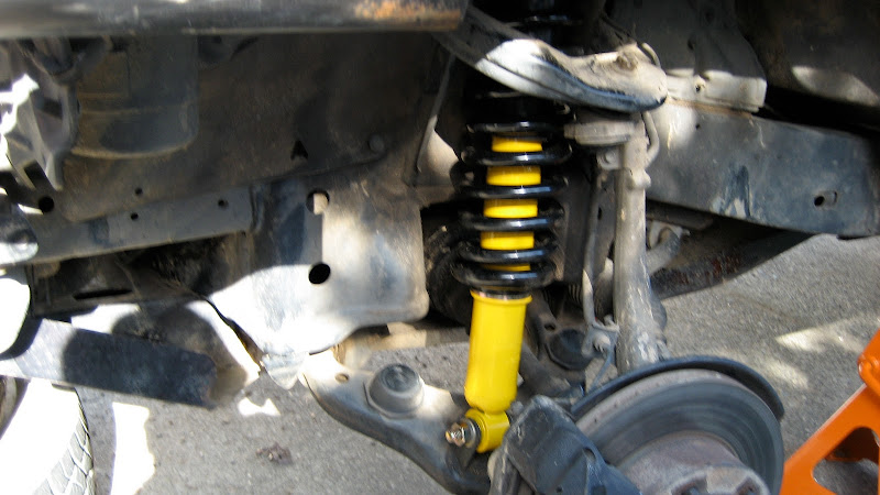

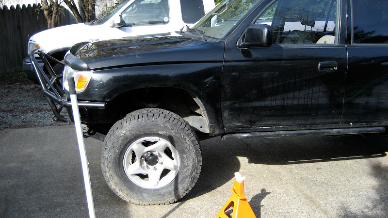

I read on one write up about using the jack to compress the upper control arm. It worked really great!
The lower shock mount didn't quite line up, but a big wrench and the 3/8" extension from my toolbox fixed it up.
This pic turned out kind of blurry, but you can see the new lower shock mount bolt, nut, and washer. It was a bear to get it all lined up, and resulted in a few smashed fingers.
All done!
Forgot to take before measurements, but after ended up at 39" ground to middle of fender on both sides.

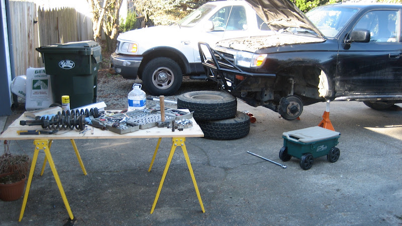

Didn't take as many pics as I was starting to get pressed for time and wanted to get done before dark.
This little guy really helped a couple of times.

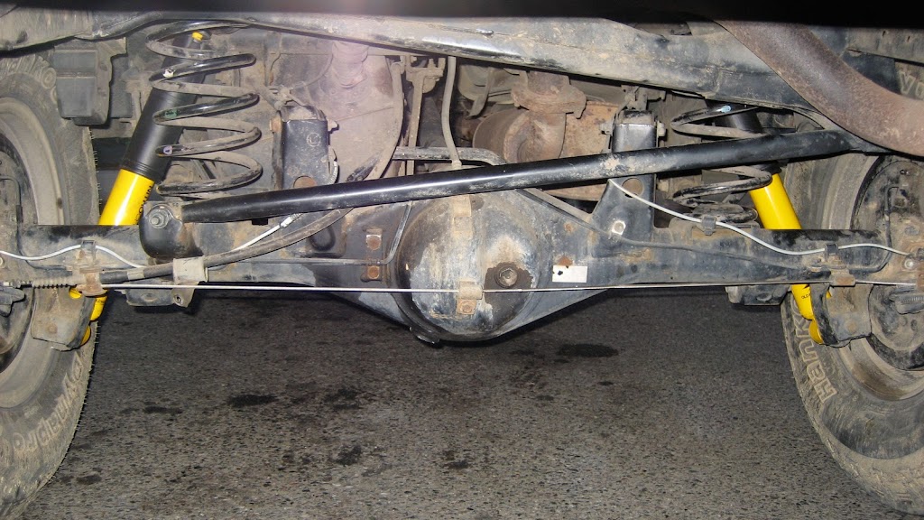

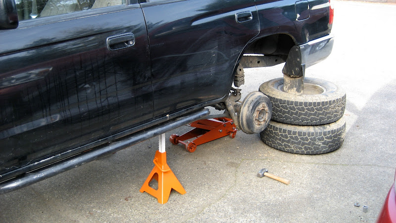

A couple of things, the rear shocks are a ***** to access! I think I still need to try and get a torque on the upper shock nut as I really wasn't able to get any loc-tite on bolt. To get the stock shocks off I used a set of pipe wrenches on the body of the shock and got a wrench on the top. I had to use the autozone spring compressors on the '80 springs to get them in, it worked out really well. Surprisingly the rear was much easier on my truck than the front. It looks like the rear brake line is long enough and would not break as it is, but I am going to add another stock line to it to be sure. I am also probably going to get the panhard bar mount on the axle extended.
Whoa! Gained 4.5" in the back! Maybe a little more in the front, need to get that winch on to get it settled down a little.

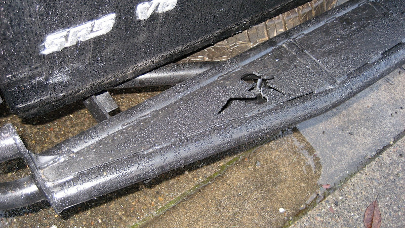

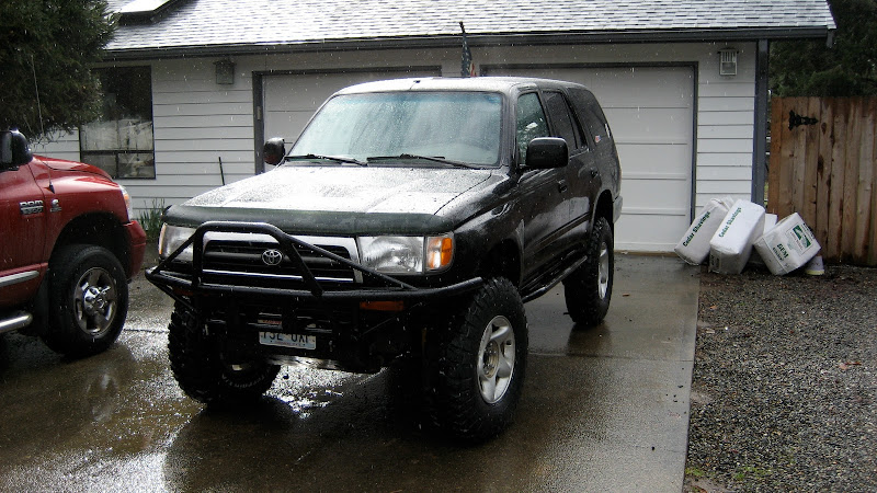

This aggression will not stand, man. So I went up to visit OCD Fab on Thursday and Gabe fixed up my gas tank with a sheet of scrap he had. He also did some bodywork on the factory gas tank skid and cut and welded together a more tougher skid plate! Hopefully it holds up better than the factory tinfoil did.
Then there was this issue.
This was the solution.

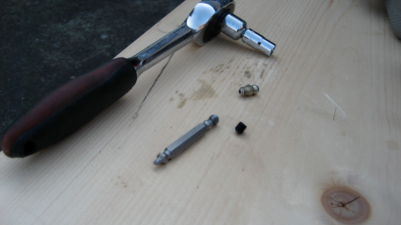

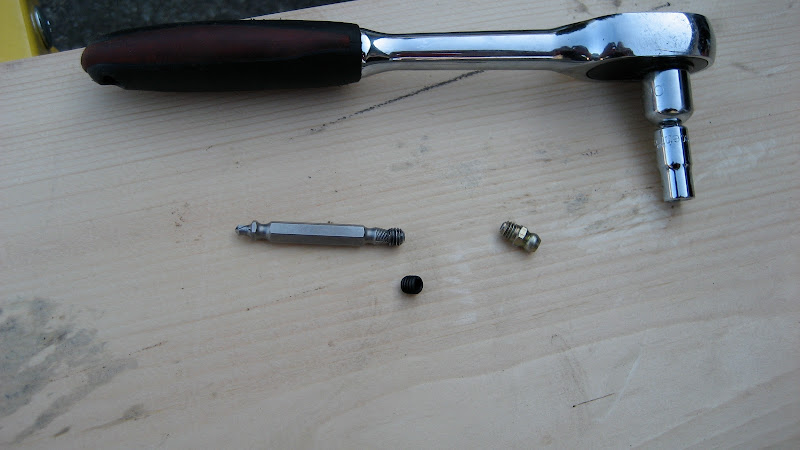

The old zerk came out easily once I figured out which side of the EZ-out to use. I put the little set screw in the hole the zerk came out of, but it seemed a little loose and didn't really tighten down effectively. So out came the loctite and I recessed it into the hole just a bit.

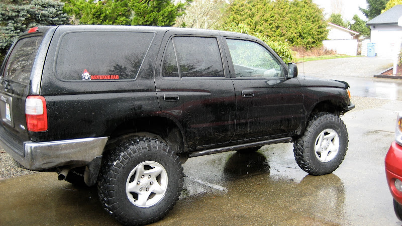

Then I noticed that my front swaybar had puked out its' rubber bushing. So I decided to remove it completely while I was under the truck. I was kind of concerned about the death roll that is reported to happen immediately after the swaybar is removed on several other forums. It is not an issue. In fact, the truck rides so much better with the swaybar removed that I could really care less if it did anything offroad! I still need to find time to get some spraypaint on various parts and put some grip tape on top of the sliders so I don;t wreck myself anymore when they are wet.

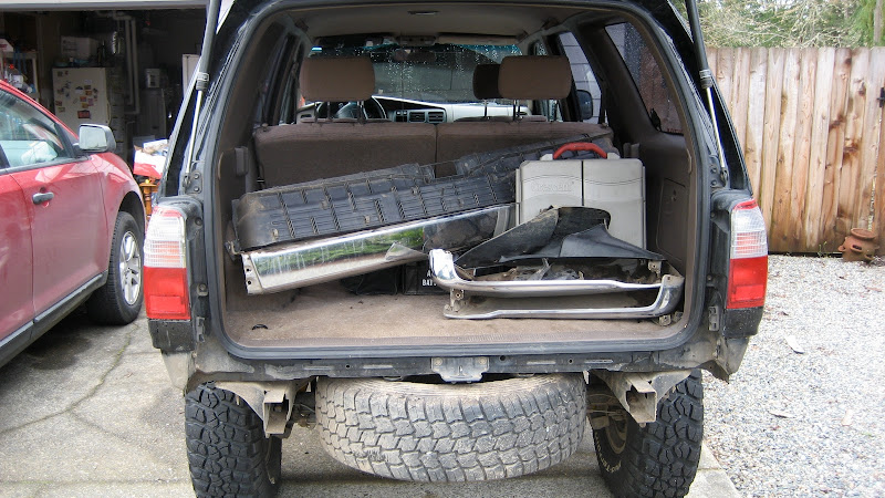

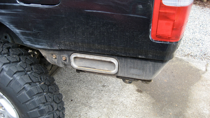

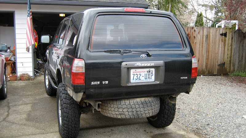

No rain so I decided to take off the rear bumper to make way for the new one WesFab is making for me.
Removal process.
All done!

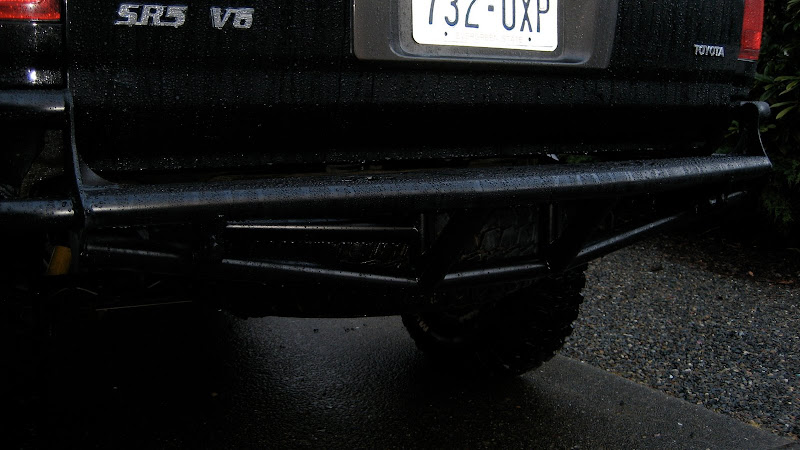

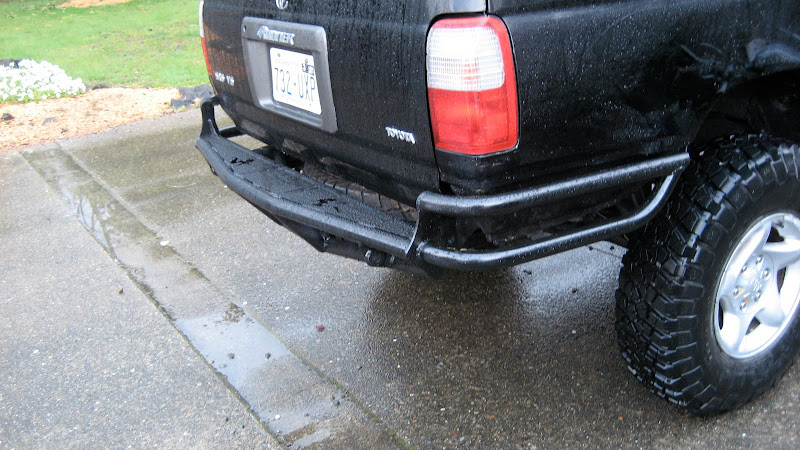

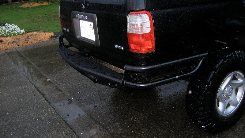

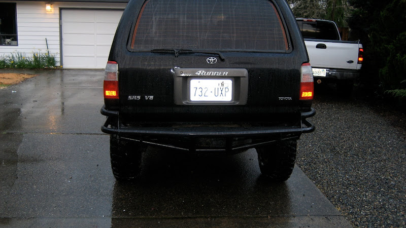

I've got a ************ new bumper!
Thanks to Wes, Phil and Brandon for building me a sweet new bumper!
