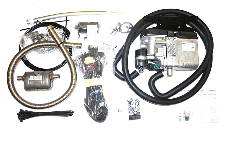

Coolant heater is the best option, just not the cheapest. Is the vehicle a camper or just a truck? the coolant heater would be a great addition to a camper.
We have the Webasto Thermotop C and it is a very good unit. I would avoid the cheap Chinese knock offs, there is a cheaper Russian option from Planar that might be an option.
I think trying to keep the engine warm with battery and limited solar is a lost cause. 20 min of pre heat is a better idea.

Enough for the 400w heater for only 3 hours. And remember that your 2.4 kwh batteries (hopefully not also tasked with starting the truck) only are good for 50% = 1.2kwh if lead acid based. Maybe half of that if cold soaked. Resistance heating is a waste of scarce high tech energy, electricity. Use your abundant diesel fuel for heat, a 5kw Thermo Top C or Planar equivalent (I second recommendation against Chinese knockoffs)uses 46w or less to run.

Rather than the diesel air heater, you could use something like Espar Hydronic D5E to heat the coolant directly. That will be very efficient in heating up the block.
SquirrelZ
That is essentially the same thing as the Webasto Thermotop C. I have owned both Espar and Webasto air heaters and they are both very good products.
My bad, I knew I should have looked it up before commenting. I have a D2 with high altitude sensor that is fantastic. Also tried two different Chinese knock offs but they both had issues between controllers, pumps and failed seals. Friend has one that works perfectly and adjusts for altitude without issue. Very hit or miss.

Money aside the hydronic is really the only option but I know a few snow bums where money is the only factor. In that case I wonder the effectiveness of a $100 airtop (hit and miss I'm told but you can return anything to Amazon) running at 100 percent for a few hours with the dog house off and a blanket over the grill. If the cabin air it brought up to 85 then I'm assuming the engine bay temp could be around 40 degrees. If it's a ambulance there's plenty of room to carry a blanket big enough to cover the grill and fender wells.
