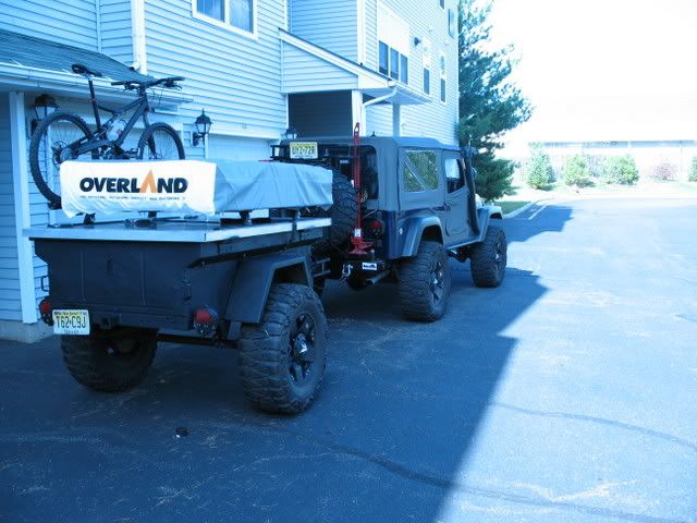

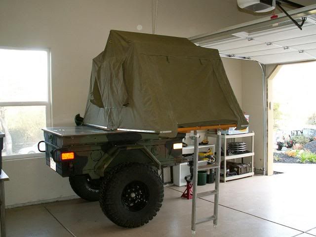

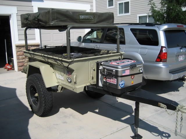

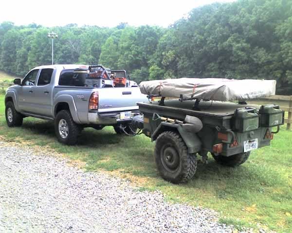

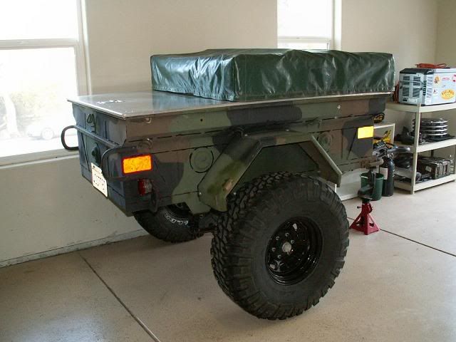

These aren't mine, just pics I have collected over time. If these are any of ya'lls, insert drooling smilie dude here.
