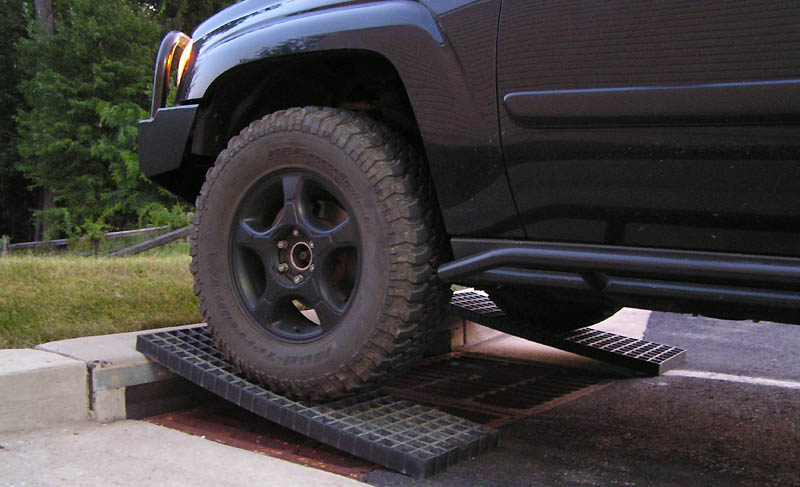

I'll comment - I like the fiberglass grid boards because they double as sand ladders and bridging ladders. I have used them to get up a wash out "shelf" and my truck weighs 7000lbs. I have the 2" ones in 48" length. They also make a great platform for showering on or washing dishes to let water through but keep you out of the mud.

I debated this heavily with myself when making my purchase. I also chose the fiberglass pads as my tool of choice as it seemed to be the most versatile option, and came with a decent price tag.

Fiberglass TrackPad:
Bridging: Excellent for bridging, however can get torn up a bit on rocks.
Sand: Decent traction, slightly worse than PSP because of the 2" thickness.
Mud: Tires have some trouble getting traction on the pad when muddy. Track pad does create a lot of traction with the mud, so it will not shoot away.
Storage: Middle weight, ~15 lbs each. 2" thick... plus serves multiple camping purposes.

I have the fiberglass grate type with non slip. 1.5" X 12 X 48
Work perfectly for sand traction,
Only issue once you've driven over them they are nicely imbedded in the sand,
so a rope handle helps with extracting them
the tie them to the rear of the vehicle trick will probably just bring you to a halt, break the lines, or catapult them towards the rear of your truck- you have been warned.
as a bridging ladder fine
but the material does not really sit well on rocks as it can splinter.

I don't carry any of the above traction devices, but I was highly impressed with the fiberglass waffle boards on the Kokopeli Trail this past summer. We used them twice to support the edge of the roadway where it was crumbling away into the abyss, and they were perfect for this. I one spot, the trail was so sketchy we would have had to turn around, or back down the canyon without them.
On the same trip also used to stand on while we took a shower. A bit sharp on the toes but did the job of keeping our feet clean and out of the mud.
They are very heavy and awkward-that is the biggest downside.
Anyway, prior to this trip, I thought they were a silly poser accessory. Now I wish I had a set.

According to the specs, my 2" fiberglass ladders can bridge a gap and support the 7000 lb truck with just 2" supported on either side. That's a max gap of 44". Granted that requires a strong ledge for support. I have used them in a ramp scenario where just an inch or two were supported. They bend a lot but don't break.
I haven't used them in sand yet. But I got stuck in snow and couldn't move forward any further. Had to back out on my same
tracks but the sun went down and the tracks we created instantly turned to ice. The ladders made for awesome traction over the ice tracks to back out again.
