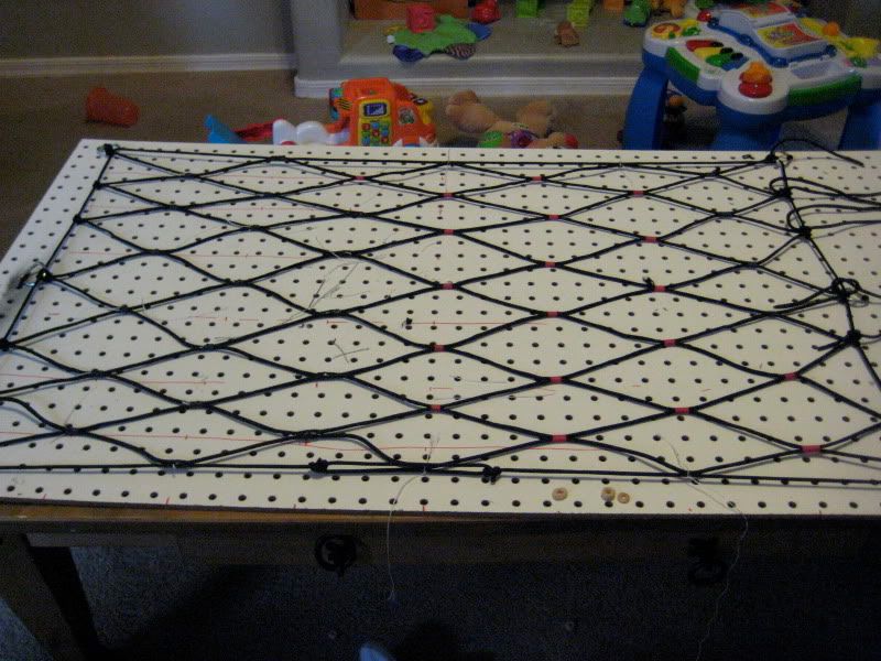

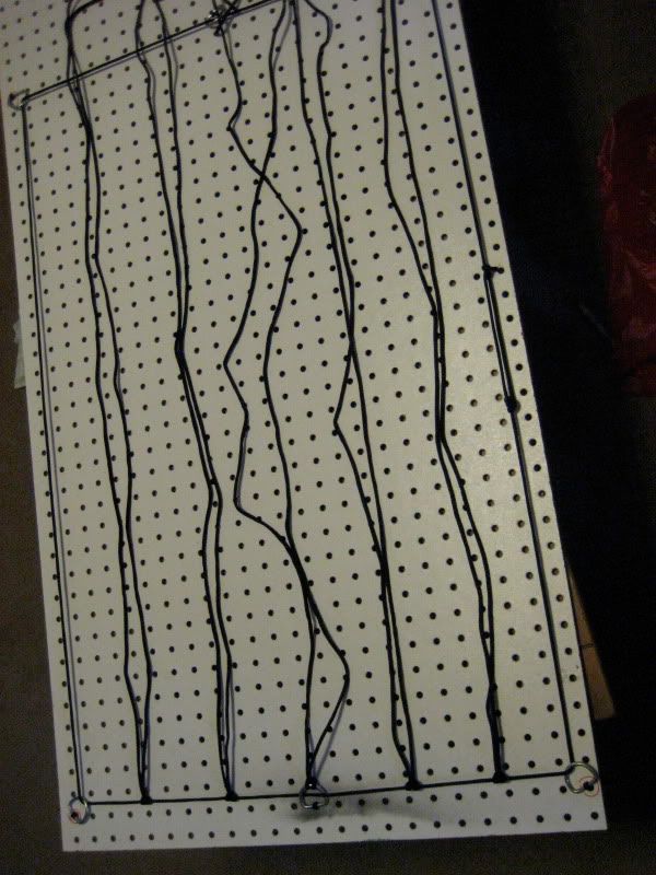

Here is an update. Normally i sew really fast but with the appendix only being gone for two days and pain meds making things so blurry i am going really slow.
First pic shows the first finished row.
The next picture, I am stitching together the two strands with old paracord inner strands with a pass through and over and pass through and then under and then use a suture knot, After that I slide shrink wrap tubing over to secure it and the heat it up.
When it is done I will snip the remaining ends and then probably make a double wrap with 100 mph tape just for good measure.
And here it is all buttoned up waiting for the 100 mph tape and should be good to go. I will use 1 inch webbing and buckles to secure it to the front sport bars and then I will have a place for small books, jackets and other misc items.

When doing a fishnet out of the inner strands i do just knot them. But this is so large that to keep them all the same tension you have to stitch them somehow. The thread is 35lb breaking strength but i stood on one end and pulled on the other and was unable to break just one.
