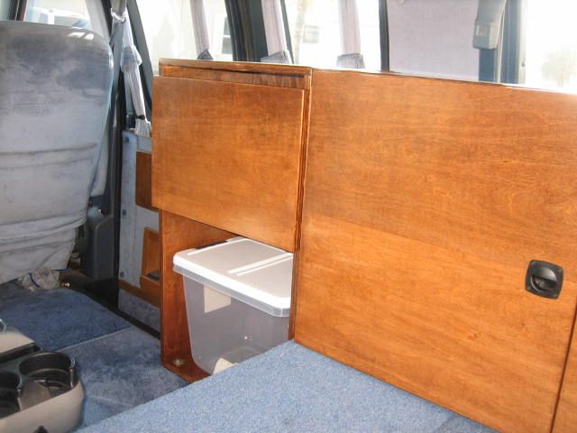

Did a little more cabinet work in the van over the weekend. Removed the fourth captains chair, as we will never need it and added a cabinet with fold down desk top for our daughter to use. And at the other end I added a little desk top I can use for my computer or to do paperwork while at job sites.
ober27
I really like the drop down desk, looks really convenient. Can you share some more details about your awning? Poles? Fabric? Center support?
