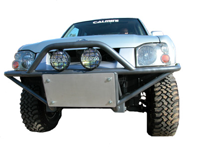

My bad, guess I need a tubing bender. Looking to make a bumper
General idea...

You'll also want to look into tube bending software which will help you lay out the project and calculate the different bends. You could plan it out and take it to a pro shop like suggested above for the bends and cuts and weld it yourself.
Some people also get a tubing notcher and some people just use a grinder to make the notches, like where the brush guard meets the horizontal tube in the picture you posted.
