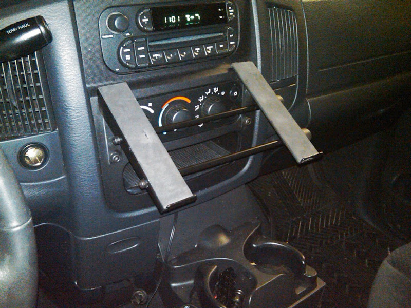

Mine would be my laptop mount that I did a few weeks ago. I'm in the process of crafting up some radio mounts so I'll have pics of that soon as well.
