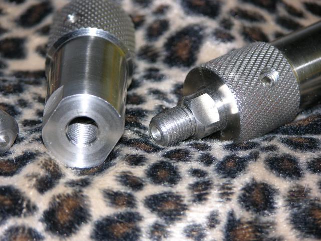

That quick disconnect is chrome plated pot metal or brass. I would only recommend using something made out of stainless to avoid corrosion problems. I would recommend something like this:
or this:
You can buy those from Bobs CB shop or directly from Jerry the machinist that made them.
I would also flip that bracket around to make it easier to open the window.

Those look pretty solid.
Unfortunately I can't flip the bracket around or it would contact the Cruiser when I open the door.
My problem was, I bought the wring spring. This one seems to be made to bolt to the mount, and then have the antenna screw into it. I ordered a new one with a female end and a male end which will fix the problem.
