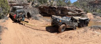

I don’t tow anything that heavy but have a couple trailers that see offroad duties behind a LandCruiser. It’s way easier to get stuck and much harder to unstuck. Especially solo. You generally get one attempt on a difficult obstacle or it’s recovery mode.

Back to towing. Sure you can buy a massive diesel 4x4 lift it, regear it, floatation tires but fact is if you get that stuck.....
I'd look into 4x4 clubs, not sure if there are courses but find a way to get exposure and mentorship. Sand can be deceptive but it sounds like you are gaining experience. With a big heavy rig far from civilization, learn to back out, turn around BEFORE getting stuck.
This is me on a high mountain pass once I hit snow, knife the trailer, drop it, turn around, recouple and go home. Saying I don't think so early is what counts.
That was exciting! Things can happen in an instant. Congrats on getting it out of there. :) Thanks for the idea of the 4 wheeler clubs - I like it!
Warning well taken! The more I get stuck and I've been stuck many times in the van - the more careful I get. That's a great example of what looks like a highly capable truck getting stuck with a not-very-big trailer behind it.... Was the problem - not enough oomph from the engine?
