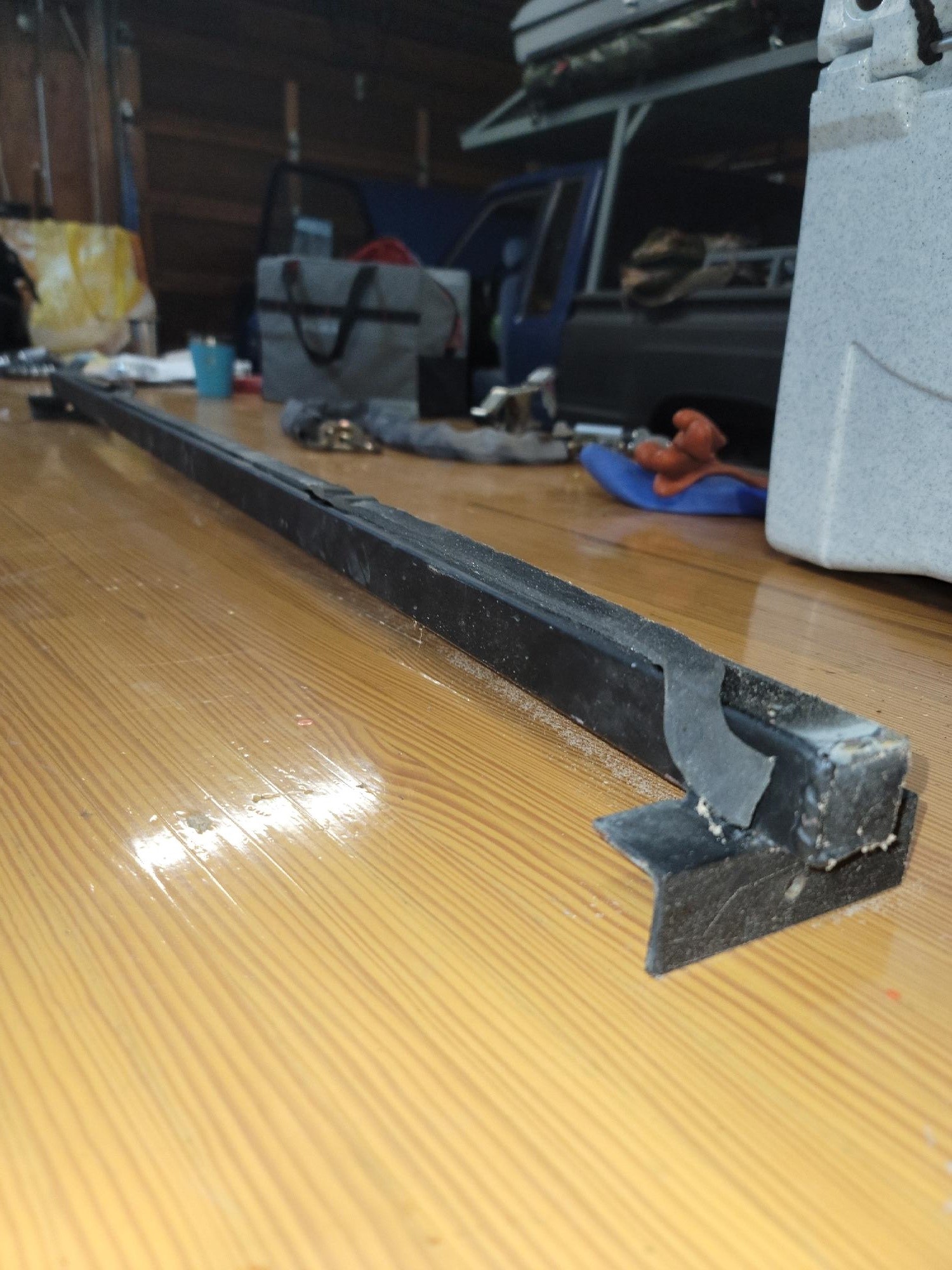

Well I deleted my first response after realizing it didn't really apply. According to the SB mounting instructions Off-the-back is just fine, but the XL tent needs three crossbars. You can fabricate three crossbars pretty easily. Here was my first shot at crossbars for my RTT on my lumber rack:
Seems like three of these with the mounting extrusions parallel to the sides of the rack should work just fine for your off-the-back application. Another idea would be to get your hands on one or two extra mounting extrusions (looks like the tent comes with two), and run the extrusions perpendicular to the rack rails, they might provide the support you'd need without the center crossbar. That wouldn't be less in line with the install instructions than fabricating the crossbars, but it might work and wouldn't require any fabrication.
I like where you are going with this. I have some unistrut I thought might be useful, just need to see how the tent situated. Luckily I'm not too fearful about modifying the rack. Thanks for the input.
