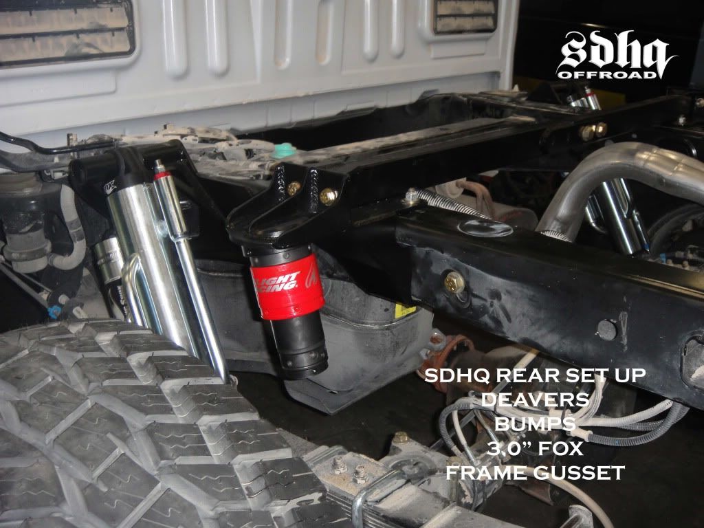

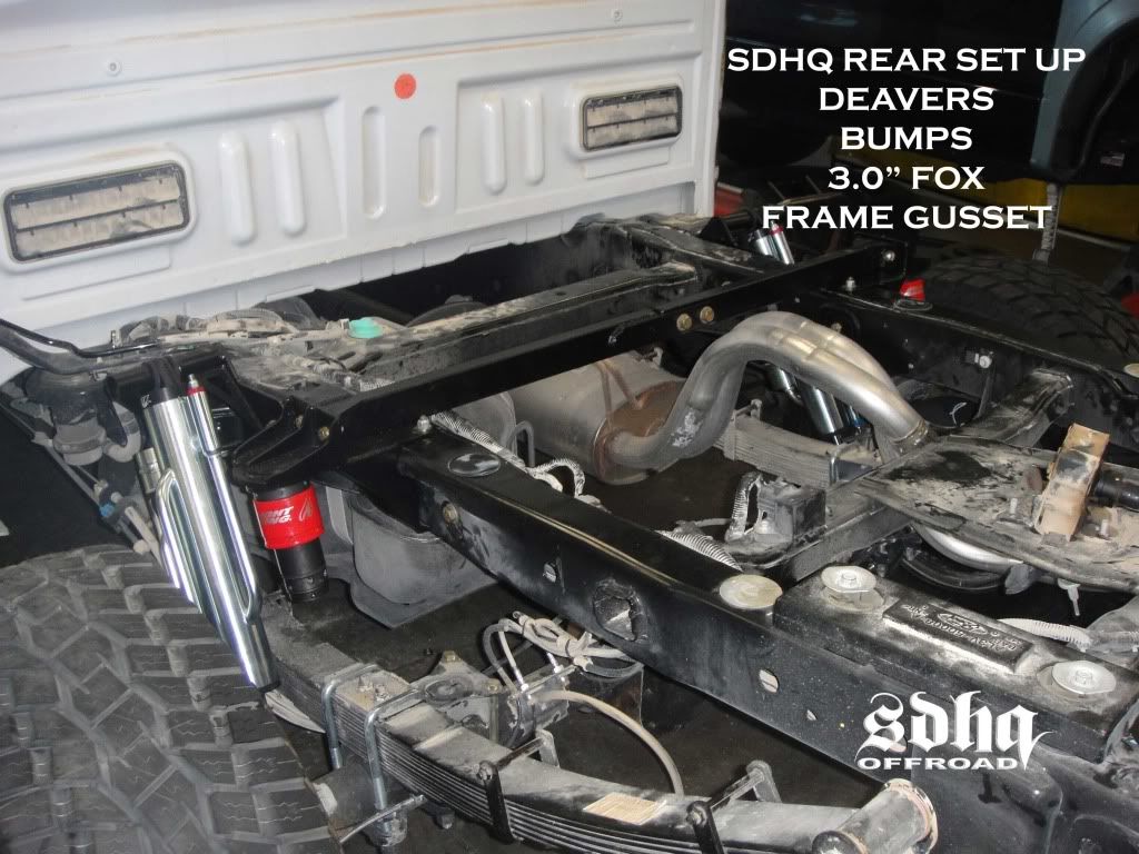

Here's one of the fixes...
Hilldweller
SE Expedition Society
There's a piece over the notorious hole, different bump-stops, different shocks....
...what else is in there?

That's what they're going with for upper shock mounts?!
C'mon Spresso,
You act like a single shear mount can be a problem given a proper flogging. Oh wait... I seem to remember a trip to Death Valley where a top of his game Trophy Truck builders' single shear mount WAS a problem.
