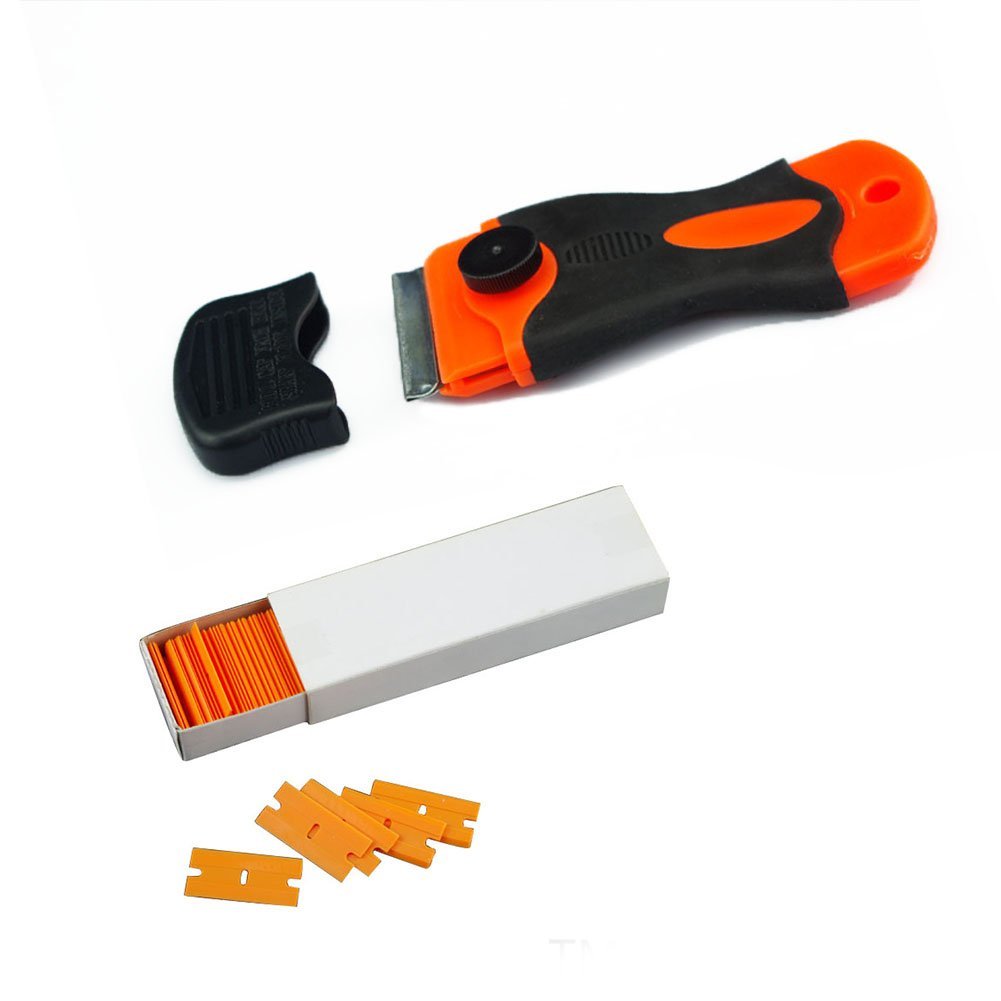

Make sure your order one of these before you start this swap. It will save you a huge headache of worrying about your paint.
https://www.amazon.com/gp/product/B01BWBSMV4/ref=oh_aui_detailpage_o00_s00?ie=UTF8&psc=1
