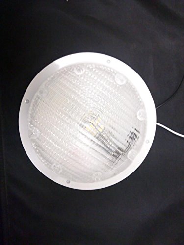

I just looked up the conversion from Lumens to Watts... they'd be on a par with a 15W Halogen bulb. That'd make them a far cry from the 50W Halogen lights that are stock. I don't think I'd need to dim them... best case they'd be on a par with the dim setting on the overhead lights.

Are you saying they draw 15 watts, or put out as much light as a 15 watt halogen?
Bikersmurf
Put out the same as a 15w halogen +/-... Vs the 50w halogen 'operating' lights that the ambulance is equipped with originally.

Here is the same light on Amazon. http://www.amazon.com/TRAILER-CAMPE...00N22DJ4M/ref=cm_cr_arp_d_product_top?ie=UTF8
It looks like all they did was take out the incandescent bulb and replace it with a cheap Chinese LED bulb, like you would use for a tail or backup light on an older vehicle.
IMO, this is a piece of junk and no where near worth $24.00.
