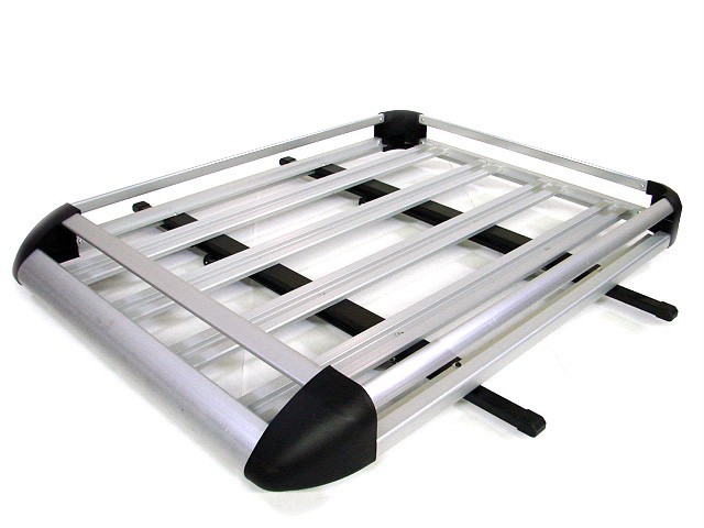

What do you think of this one?
It has plastic corners but looks relatively strong to me.
similar but silver and black.
last one is the basic yakima basket case.
With two action packers and firewood you could easily go over 100 lbs of weight - not only does that cause a fair amount of torsional stress on the basket it can also become a missile in an accident if the basket fails. Quality is important.
You're not going to find much in the $100 price range, but out of the ones you have above I would go with the Yakima. They make quality products and I am surprised that you could find one of their products for $100.

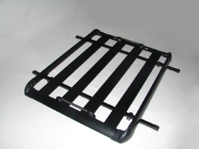

ok round two....
$115 Black widow
43.5" long x 39" wide x 6" tall
$125 Stingray
52.5" L x 43.5" x 5.25" H

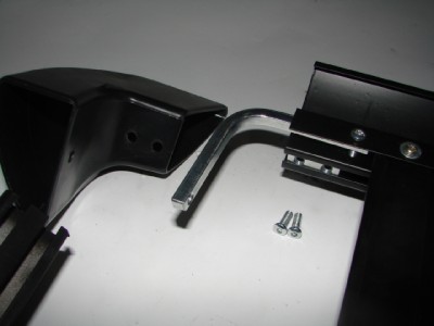

They both come with better mounting hardware also:
That one almost looks like the "stingray." How do you like the mounting hardware?
No I have the ER-08208....
The hardware works as it should. My problem is the stock cross bars on the XJ suck. So the whole thing rattles a lot on rutted roads. A fix is pending.
The clamps work well but make sure you replace all the nuts with Nyloc nuts, or at least use Loctite. And if the Allen screws are "tamper resistant", be sure and toss the allen key into your tool box..... Ask me how I know!:bike_rider:
