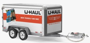

3/4” doesn’t seem like enough clearance with aluminum.
We rented a 5’ x 12’ trailer from UHaul. Its aluminum roof got hot enough in the sun on cooler day to give me a first degree burn on my arm, when I brushed my arm against it. It was still very hot if you were an inch away. I’d be concerned that the aluminum would absorb the heat from the sun and then transfer it to your roof.
The one difference being that there wasn’t as much circulation, but I don’t think 3/4 of an inch would be enough.

What color was it? There is a reason why airplanes where originally bare aluminum, and now they are painted white (mostly).
Aluminum is a great heat conductor which is why if it's hot, it will burn. An insulative material would be much less obvious at the same temperature.

Oxidized Aluminum. Super hot in the sun.
