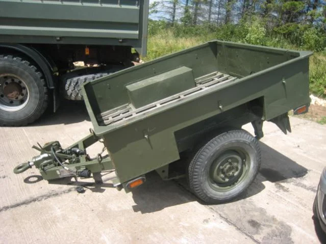

I've got a wide track Sankey MkIII and I'm thinking of ways to make it better for trips/camping. I had intended to just put a roof tent on it but I got to thinking that some thing more secure and insulated might be nice for winter trips and trips in less camping friendly areas.
Has anyone made or seen an camper pod or insert that fits into a Sankey body? Something like a pickup camper, put it in when you are taking a trip and take it out when you want the trailer to be used for hauling wood and trips to the dump. Maybe put jacks on the pod so that the unit can be dismounted very easily.
Another option might be to make a unit that bolts down onto the Sankey frame in place of the steel body but I thought the insert would be easier but heavier.

I just had to google and find out WTH a Sankey was. lol..So now I know. I would take it to a Truck Topper shop and have them measure it and see what may fit.
