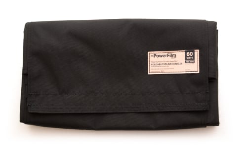

Otherwise, I think these are the smallest, lightest, high quality panels you can get to setup and put away:
For use in marine or wet environments they do make a waterproof roll-up model. These are proven in both HAM use and the military.
I think for your situation some kind of deployable panel(s) would work but note that I've found my "house" battery (Battle Born 100AH) can go 2-4 days without needing a charge. Perhaps you don't need solar at all if you move (or start) your rig every few days and have a high quality DC->DC charger. I'm very happy with the 30A Victron:
