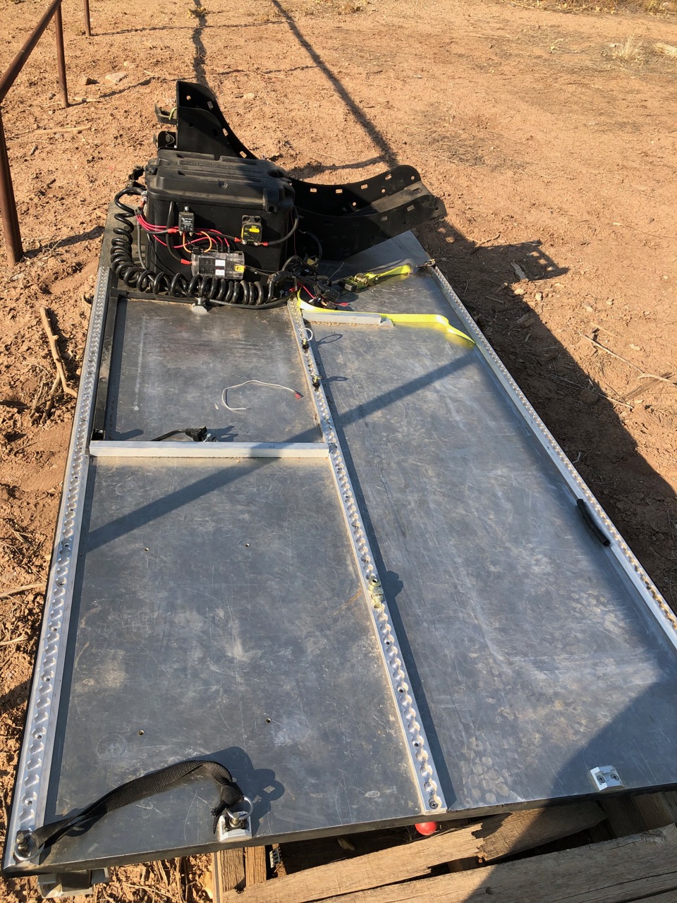

Slide-Master brand cargo slide for full size pickups. 1000lb capacity.
Will fit in any full-size pickup bed that is at least 48” wide between the wheel wells x 96” long from front wall to closed tailgate. Unlike many others on the market, it can be fully extended all the way out of the bed while loaded to capacity.
The frame is steel and the deck is 3/4” plywood and 1/8” aluminum. The decking is replaceable if you want to do something different, but why? :D
The slide comes as shown in the first 3 pictures. The fridge, Toyo MT, CO2 bottle, boxes, etc are not included.
There are three rows of l-track for tie down points that extends approximately 6’.

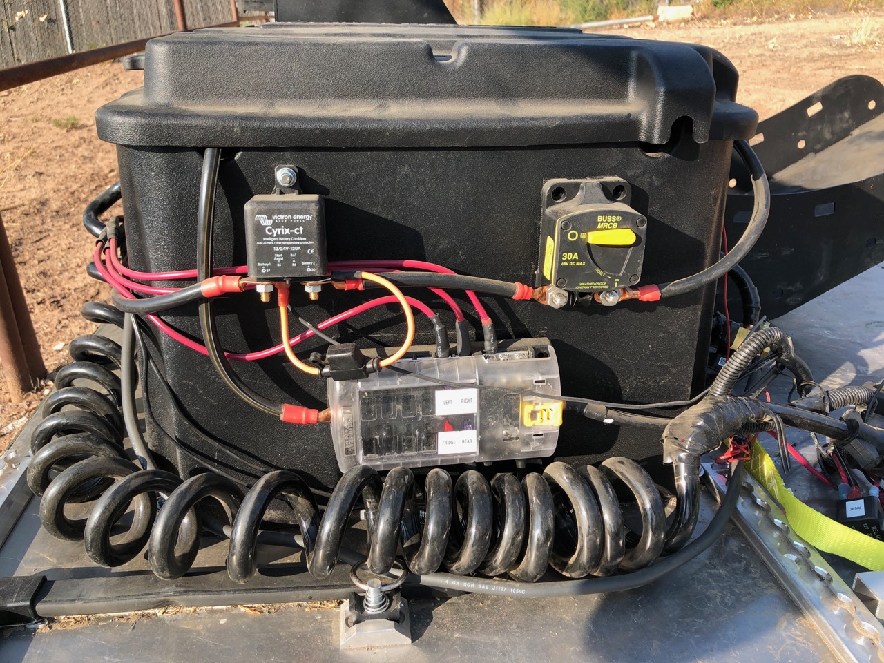

The final two feet are dedicated to systems and gear. There is a battery box that includes 2 GC2 sized deep cycle batteries with 210AH of capacity. It is designed to be charged via a 7-pin trailer plug utilizing a Victron Cyrix charging relay. This isolates the house from the starter batteries when the alterntor is off and ties them together then the alternator is running. The batteries can be monitored through the Victron SmartShunt and its free app.

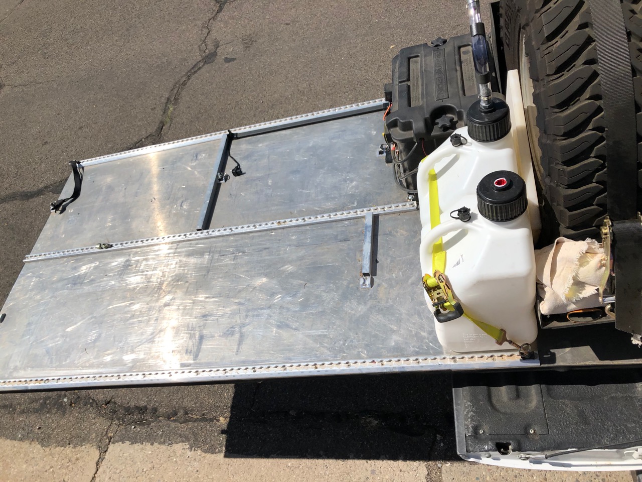

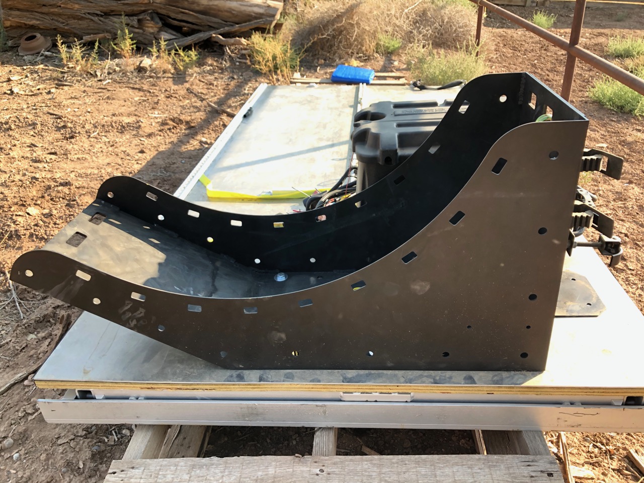

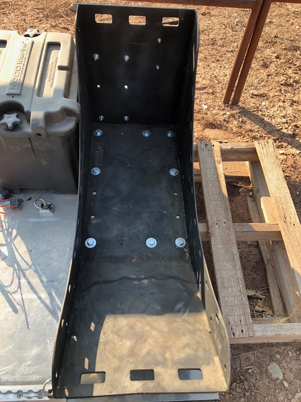

There is also a spare tire carrier that can accommodate a 33”-35” tire. I had a 33" spare; fitting a 35" would be quite tight for most cab-height shells.

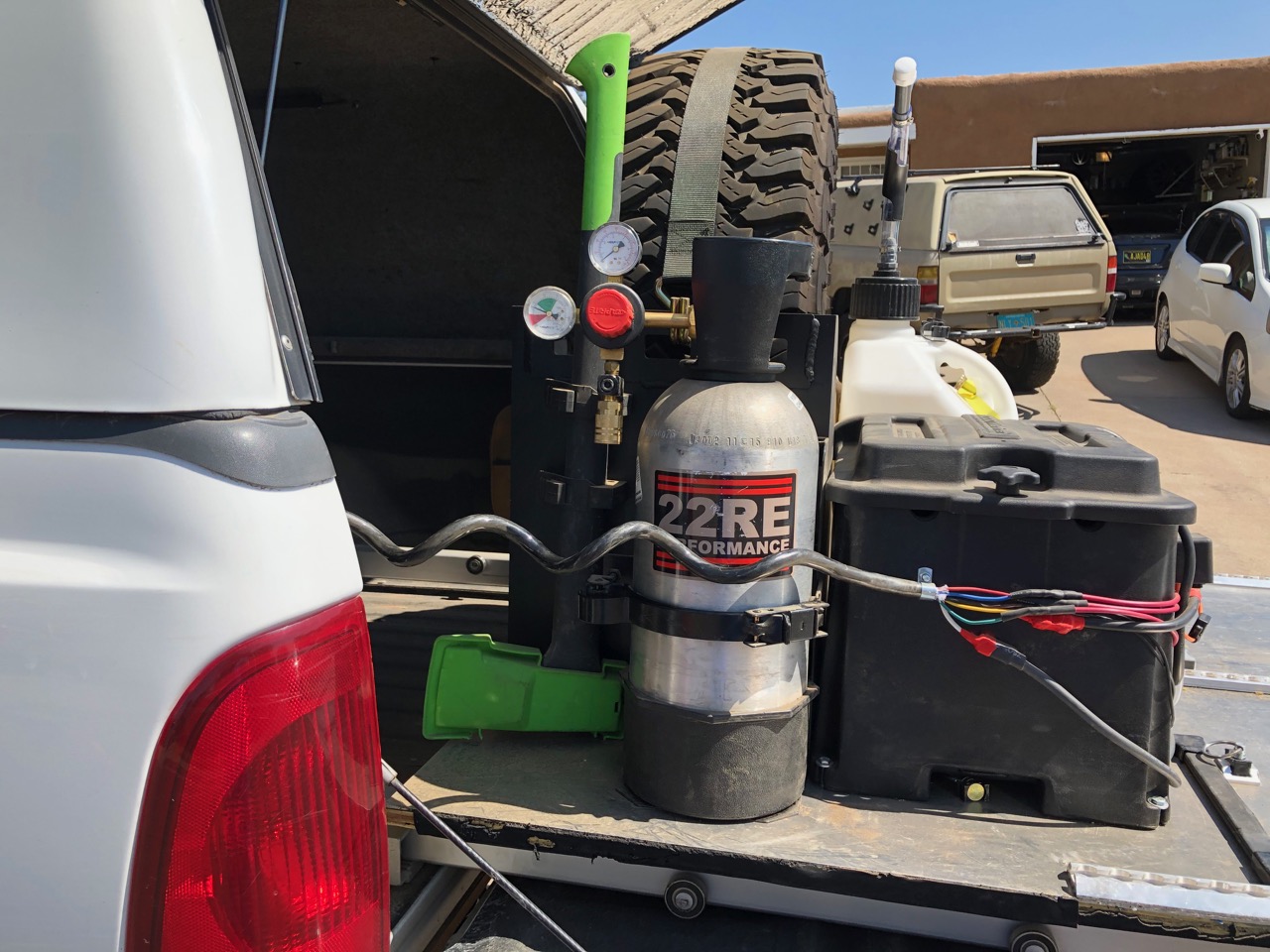

Next to the spare tire carrier is a CO2 bottle mount and some Quik-Fists for whatever you want.

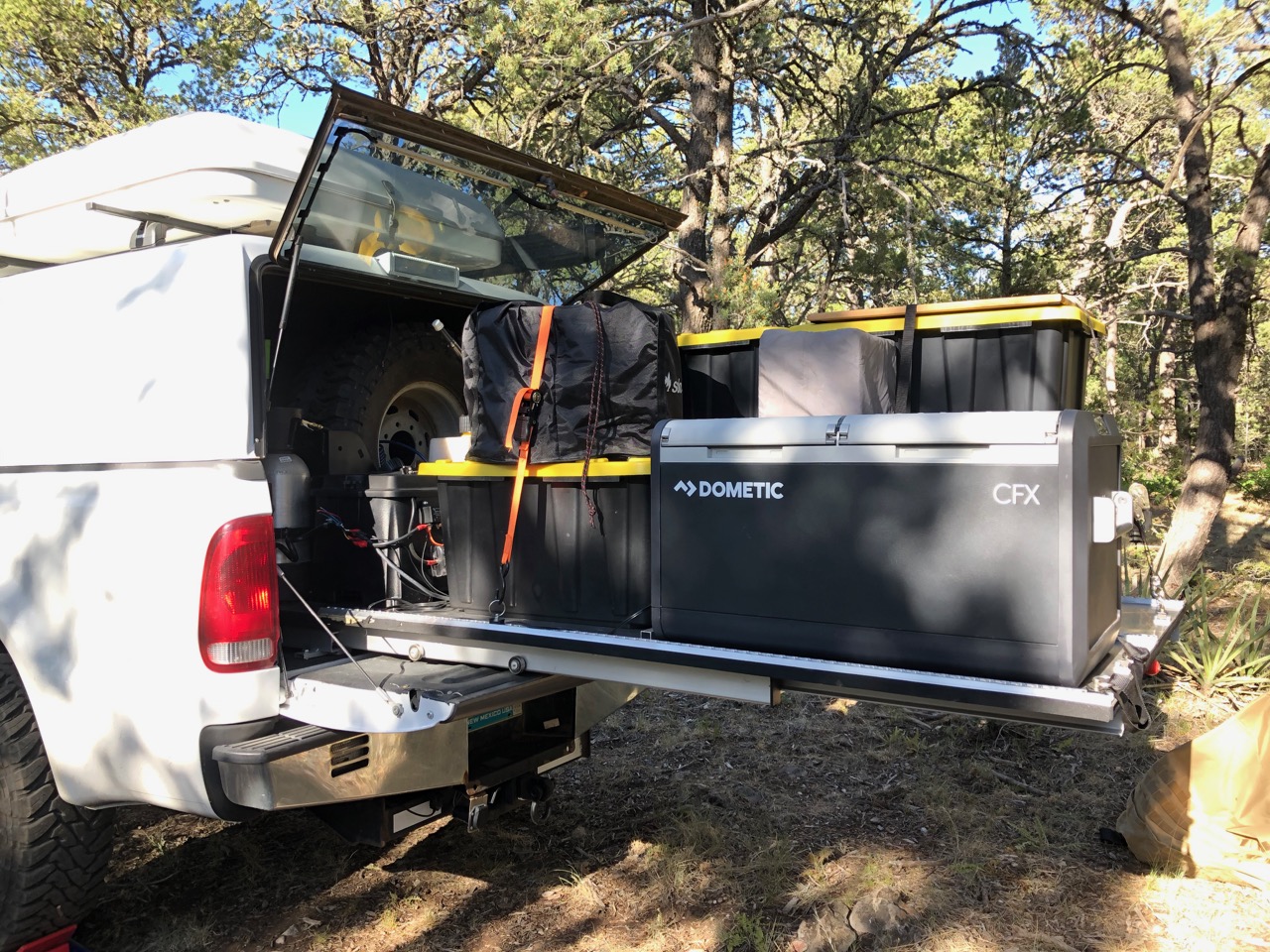

The driver's side rear corner was dedicated to the fridge. The bolt holes will accommodate a Dometic CFX75.

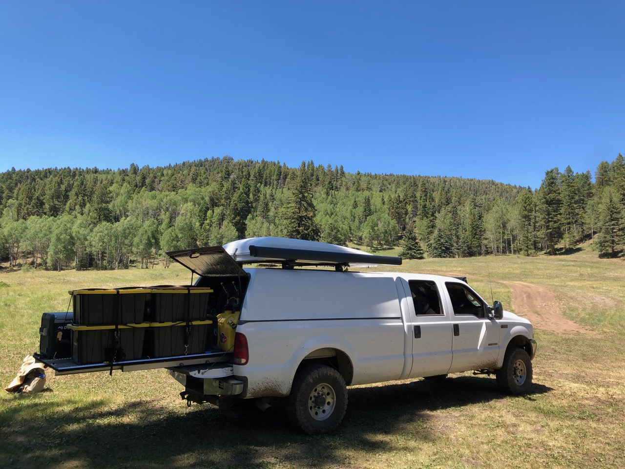

Examples of how this slide was loaded. This is at 75% extension. This was usually the furthest we'd pull it out while loaded. It gave unlimited access to all of the stuff that normally needed to come out.
We used Home Depot totes and these were easy to get out at 75% extension. No deflection of the tray even fully loaded and fully extended.

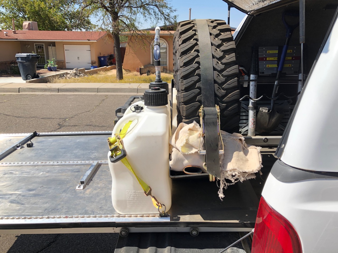

Driver's side at full extension. CO2 bottle holder can hold 10-15lb bottle. Using coiled tubing and a multi-tire inflation system, I could use the bottle to reinflate all four tires at once with the slide closed.

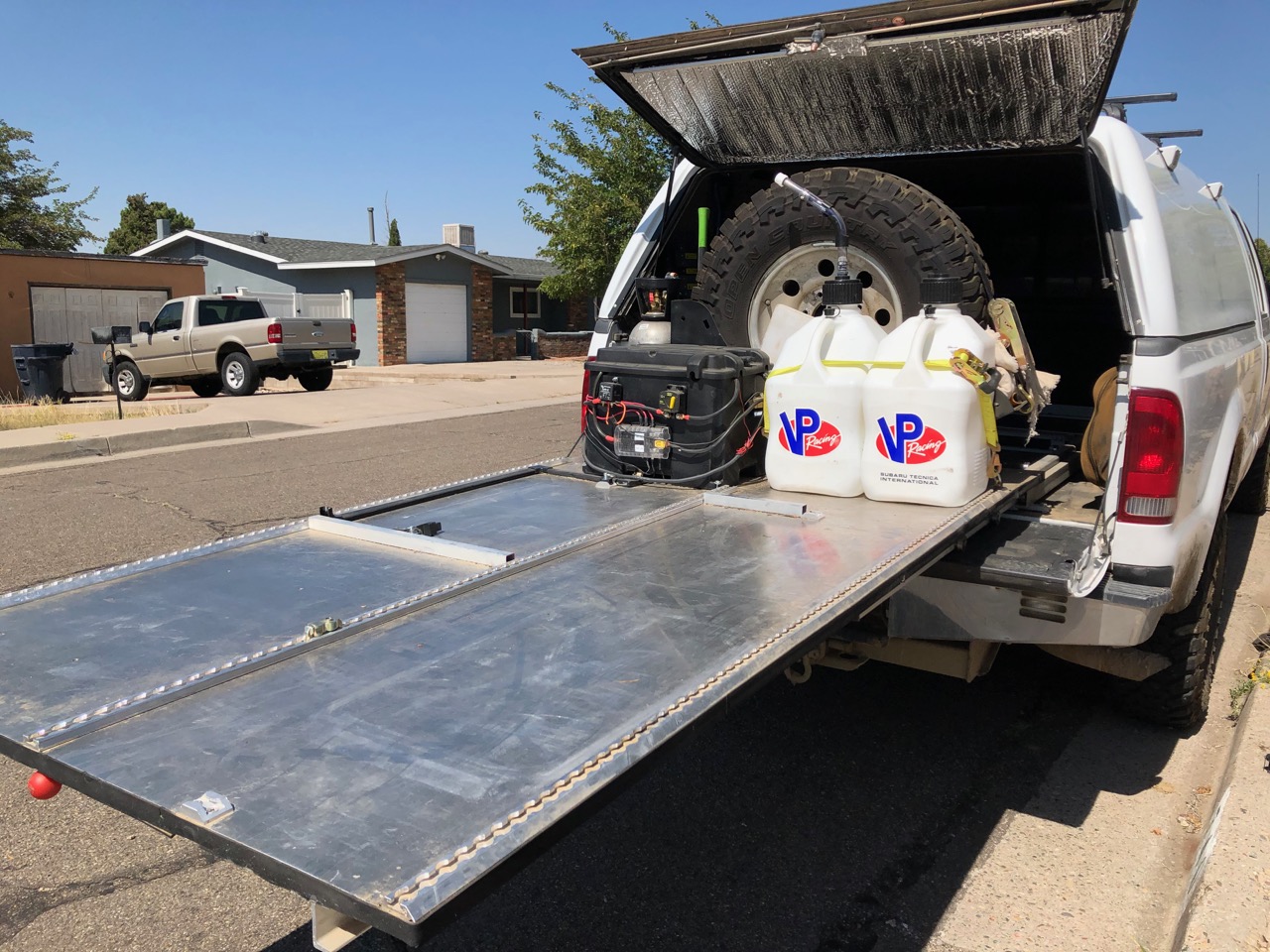

Passenger side at full extension. The tire is easily removed in this position.
The area in front of the spare is sized to fit VP bottles. We had both diesel and water bottles as the circumstances dictates.
