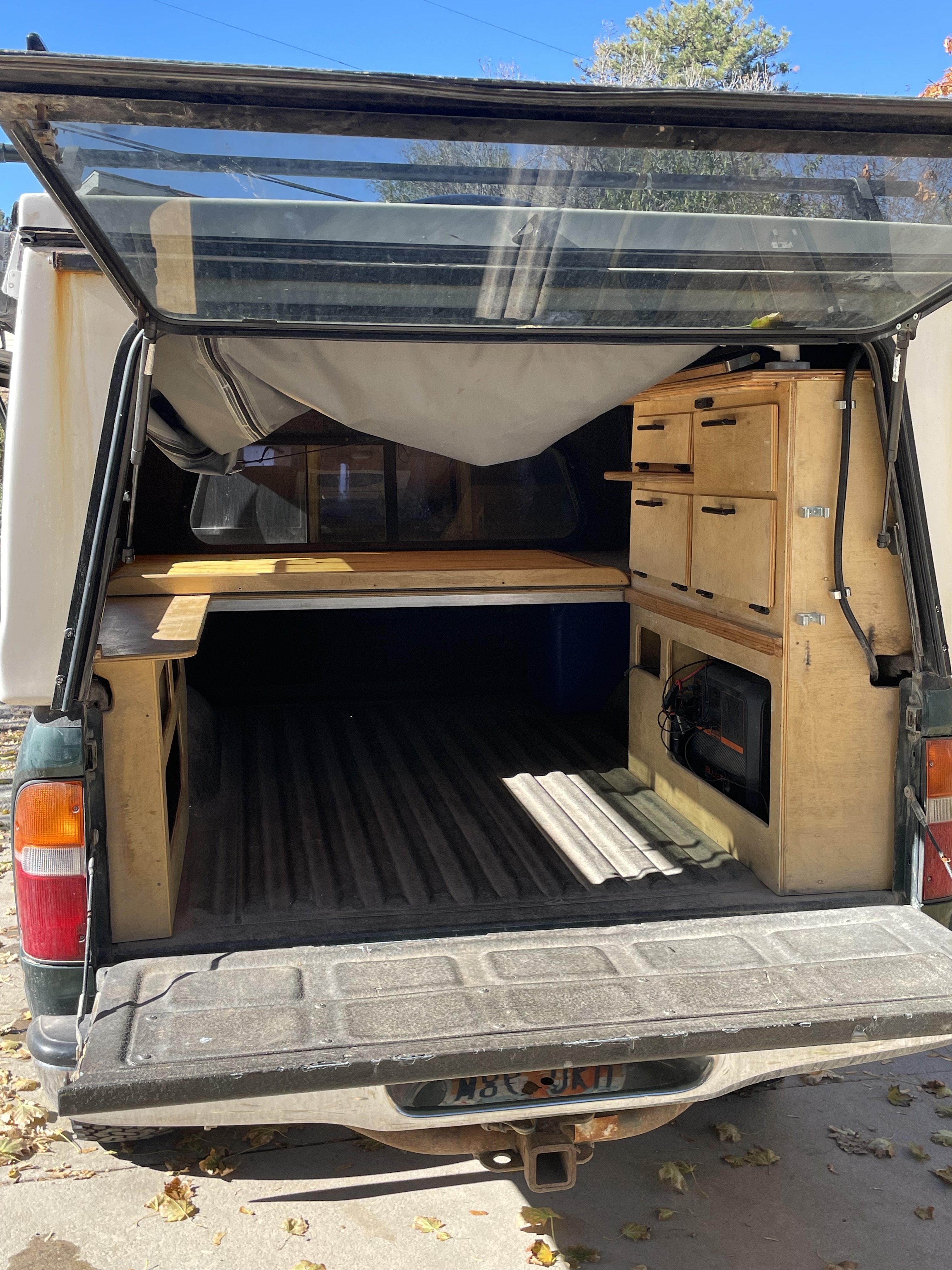

Hello! Selling my custom build and custom camper that i've been happily using for the past 4 years. Thing is a beaut and ready for the next owner!

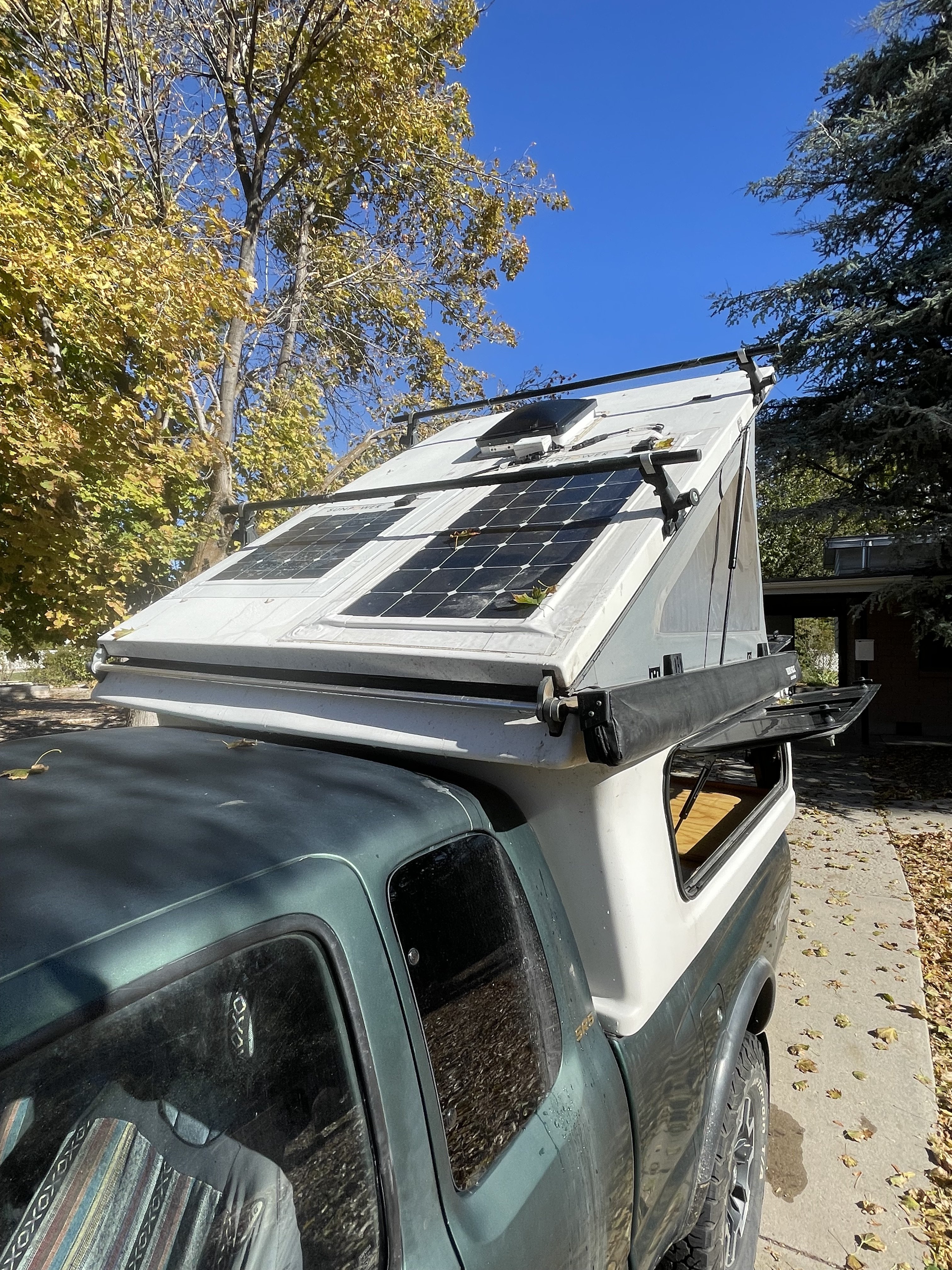

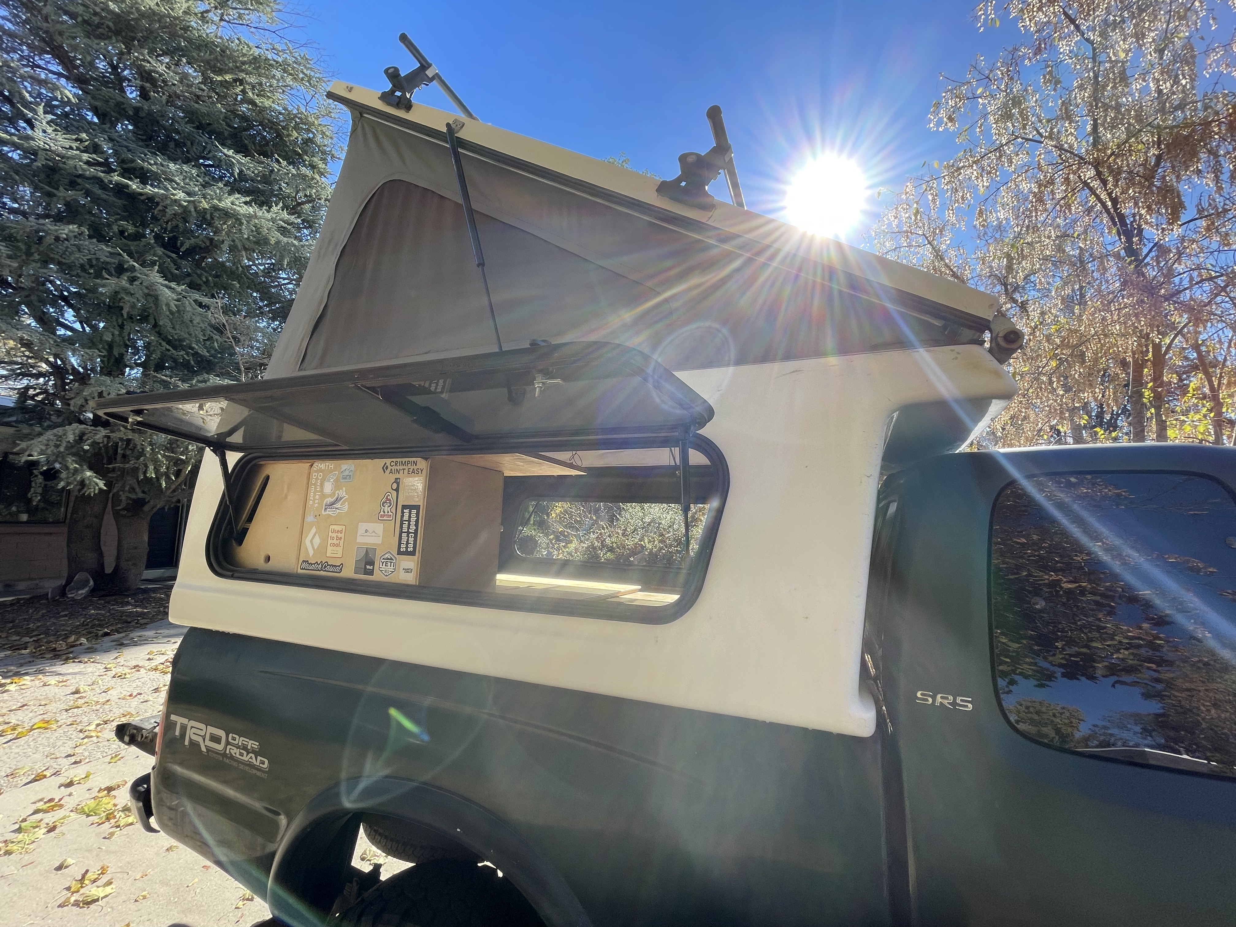

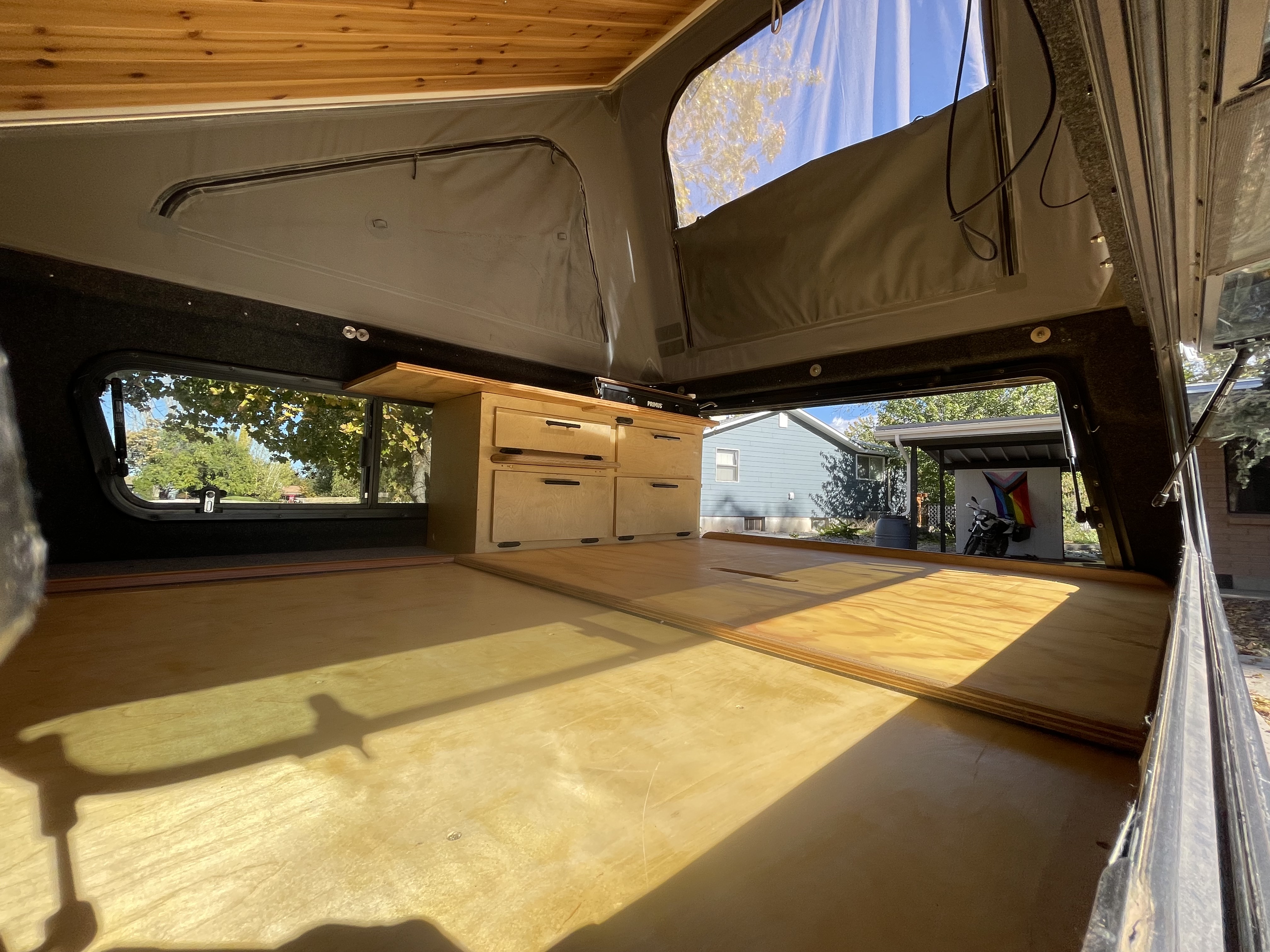

The Camper: I converted an original Flippac that had a broken torsion bar into a wedge style camper. Two 100lb (newly replaced this week) gas struts raise the camper hands free. The custom tent build was designed and sewn in an industrial sew lab. All seams have been fully taped and corners are reinforced with heat press patches. Also there are heat pressed lash points for the internal bungee system that pulls in the tent for easy no snag lowering. Has Tthree large, zipper opening windows with bug mesh. The Fiberglass flip pac is in pretty good shape. Has a few cracks which have been there since I bought the shell four years ago. Both side windows have been converted to fully opening windoors that also have slide open windows with bug screen. The ceiling is fully insulated and wood clad with 1/4" cedar.
The Roof: INCLUDED with the camper on the roof:
  • 150 WATT Renogy solar panels. Installed and wiring ran internally ready to plug in
  • Roof rack
  • FanTastic Ceiling fan Vent - 1250 Series
  • Overhead USB plug in light ( With inline switch )
The Buildout (Optional but recommended with purchase)

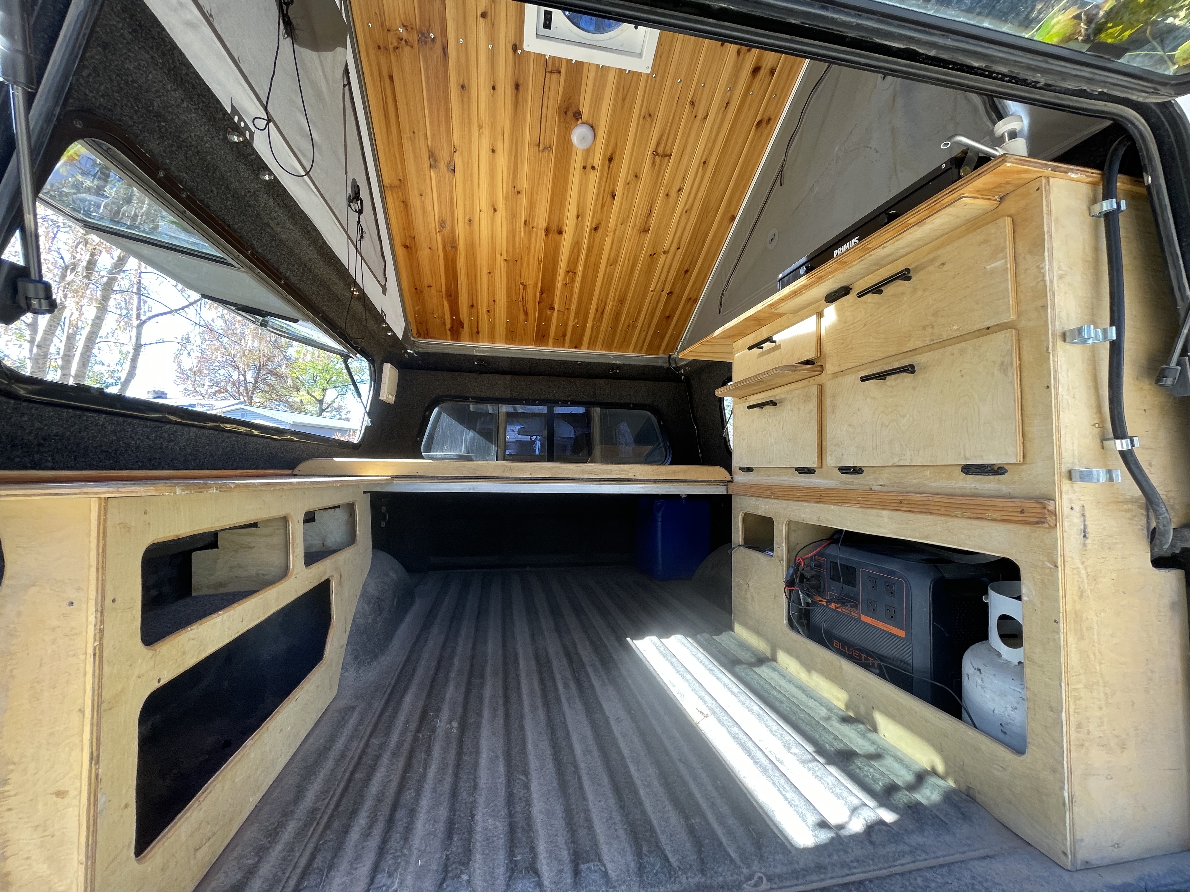

Fully custom aluminum/wood buildout includes:

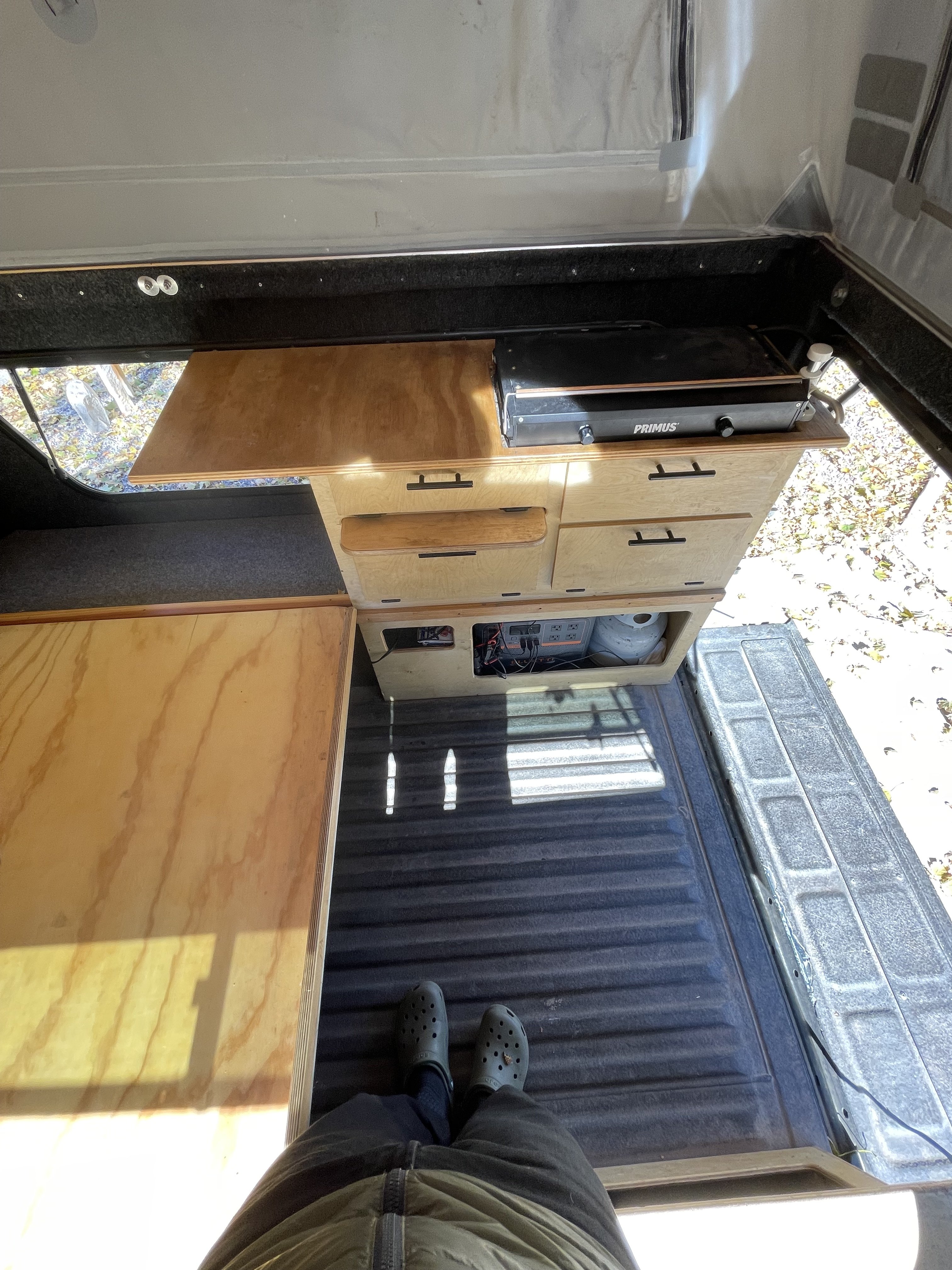

  • Sliding bed platform . When pushed in as "couch" mode, it allows for open kitchen standing room. Bed platform pulls out to deploy into 48" x 6' long bed. (double camp pad / cushions not included)
  • Kitchen has four cabinet shelves and large lower opening that fits 1 gallon propane and battery (NOT INCLUDED)
  • Primus double burner stove is recessed into counter for seamless fit (INCLUDED) and marine handpump is mounted right of stove (INCLUDED)
  • Main couch zone is reinforced with 1x1" aluminum crossbars.
CAMPER BUILDOUT WILL FIT PERFECTLY ON 6FT 1ST GENERATION TACOMA. It is built onto the side bumpouts of the flip pac so i'm guessing it would also fit "easily" (Possibly minor modifications to backside of kitchen) onto a 2nd or 3rd gen tacoma 6ft bed.
Would prefer to sell with buildout but also willing to sell just the flip pac wedge camper.
$4500 - Camper only (With 150 watt solar , roof bars, ceiling fan)
$5500 - Camper and Buildout (With stove and hand pump)
