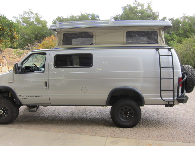

2005 EB350 diesel SMB 4x4
24639 miles
Sportsmobile penthouse top

Sportsmobile (not Quigley) 4x4
includes AA Atlas transfer case
Old man emu shocks
New (under 100 miles) BFG AT E rated tires (5)

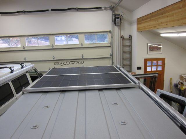

128 watt roof mounted solar system
Blue sky 2000E MPPT solar charge controller

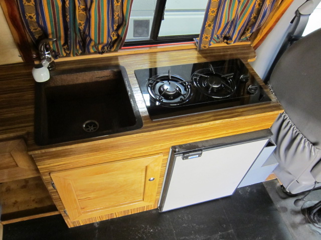

Princess marine dual cooktop with external (under the van) mounted removeable

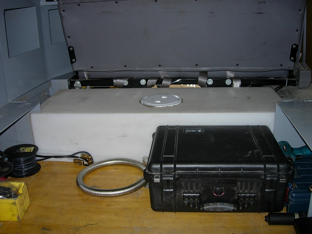

29 gallon on board water storage

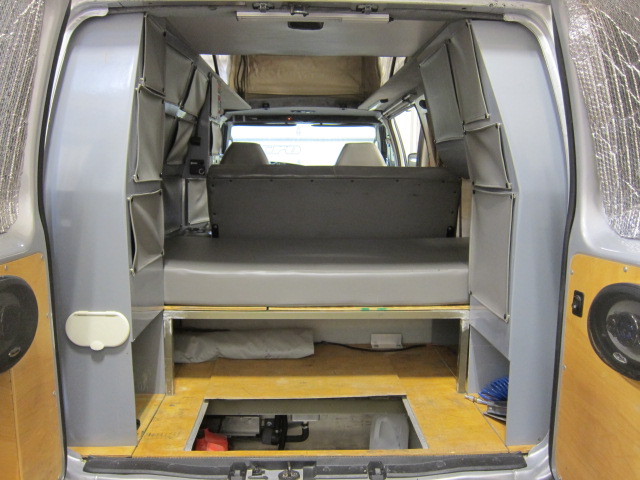

rear under floor storage
Rear shower and portapottie storage (not in the galley!)

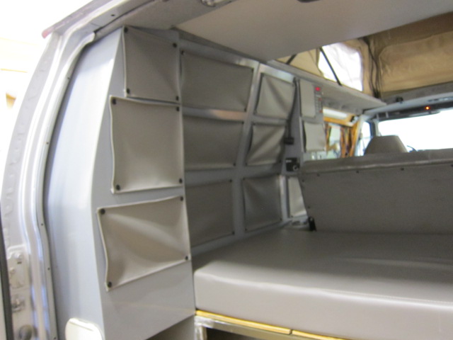

The interior is laid out like a VW westfalia with a forward facing rear seat that folds into a bed (OE sportsmobile). The seat has seat belts for three persons but this would only work with children. Two adults pretty much take up the seat. The galley is on the left with the fridge behind the drivers seat. The cabinets are constructed of 1/8th" birch plywood held together with fiberglass tape and west systems
epoxy. This is a pretty standard construction method for boats. The cabinets are very light, strong and waterproof (no rotting etc). They also don't have screws or nails to come loose or rattle.

The water tank holds 29 gallons. It's directly between the rear wheel wells behind the back seat so the weight is directly over the rear axel. The hot water heater holds 6 gallons. So that's a total of 35 gallons. When the vehicle is being driven it's heating the water in the tank up to engine operating temp so about 200 deg F. It's got a mixing valve to bring that down to domestic hot water temps so you get more than 6 gallons of hot water out of the tank if that makes sense.
Yes the 6.0 is stock and it is completely stock except for the addition of a coolant filter in the coolant supply line to the hot water heater. BTW when I installed the heater I did it right by buying the factory hoses and heat shields for a passenger van with rear heater rather than just cut in and install a plastic tee and a bunch of hose clamps. Significantly more time and $$ to do it this way but much cleaner and more importantly far less likely to develop a leak because it's rubbing somewhere it should not be.
