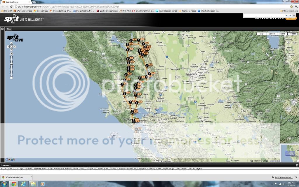

The spot website has a shared page. You can give a website link to whoever you would like to be able to follow your progress on a trip.
My Gal keeps this page bookmarked to follow me on my rides. It's also useful if you are joining a group and as long as they have web access they can track your progress. This has been handy a few times with my friends using their smart phones to see where I'm at when they are waiting for me at a meet up point.
Screen Grab of my SPOT shared page.

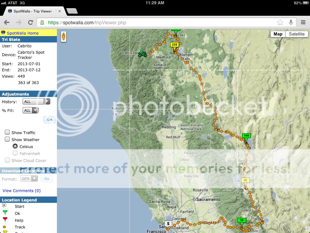

The problem with Spot is that it only saves the tracking info for a few days. This is where a third party website comes in handy. I like Spotwalla - Same as the SPOT page you can give out a public website to others that you want to follow you. You can set up all sorts of security parameters on Spotwalla so only the people you want to see you have access to do so.
With Spotwalla you can set up multiple "Trips" with start and end dates. The tracking info stays forever. That way I can go back and check where I've been on a map later when I get home. I do this for individual trips and I also set up an open-ended trip to track my overall travels. My sig line has my current trip link.
Screen grabs from a few Spotwalla trips.
On both SPOT and Spotwalla you can zoom in and out on the maps. You can also grab GPS coordinates by clicking on the bread crumbs left on the map. Nice when you want to find a cool location that you marked during a trip.
