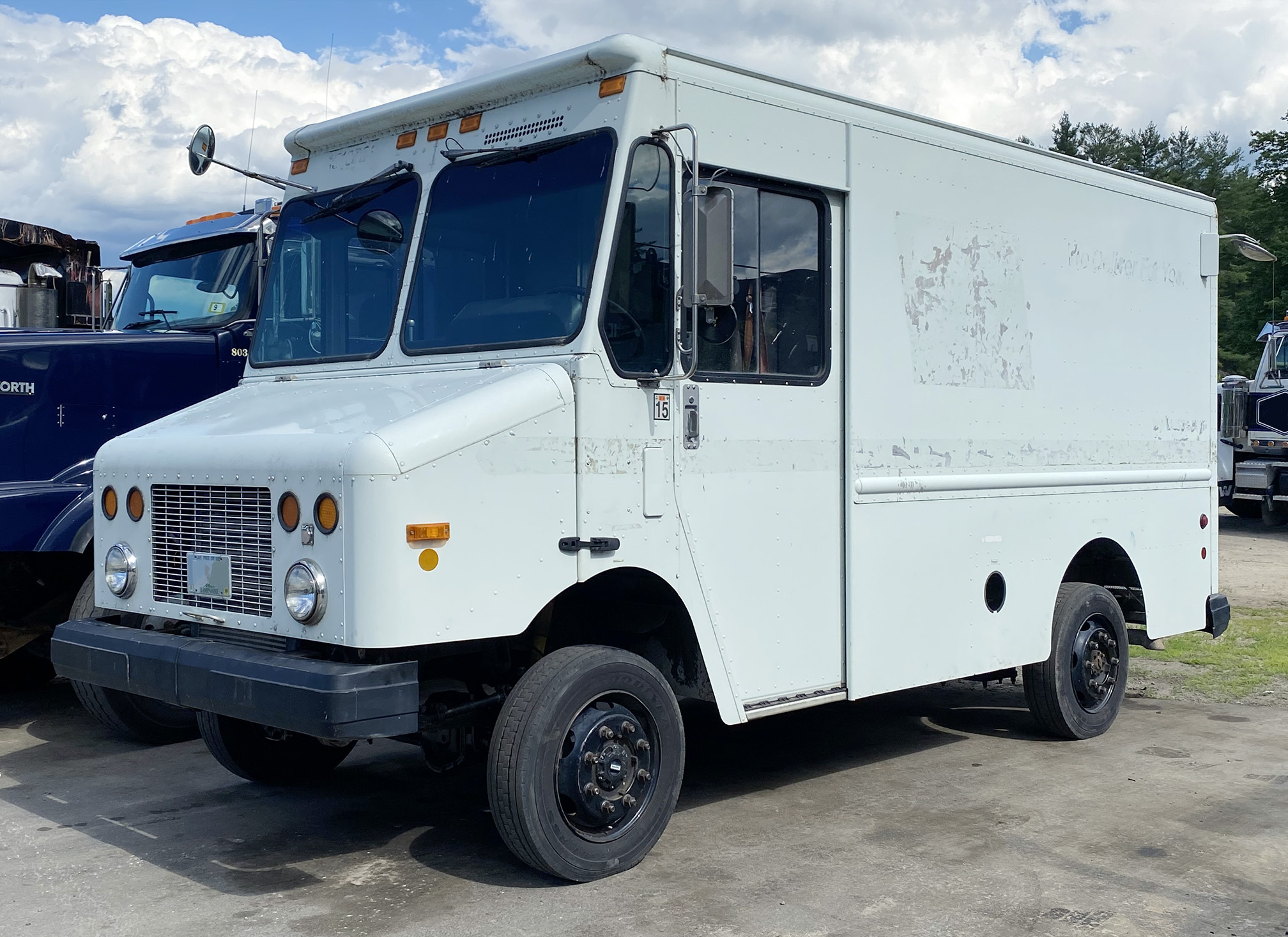

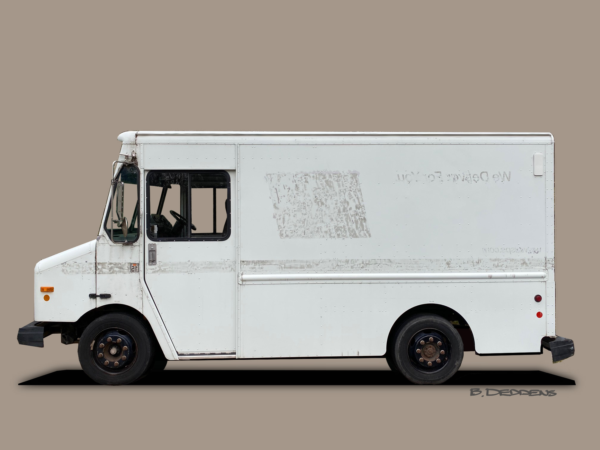

Before (photo of actual truck)
This model was preferred for me instead of larger stepvans because of the 138" wheelbase and the standard single rear-wheels - they provide better appearance & seem easier to configure preferred backspacing. Chassis appears to be identical on higher weight rated MT45's except for the rear axle. It's almost the same specs as a Unimog U-4000, or a Ford F550. Turning radius seems tighter than my honda pilot, and it's ~20' long bumper-bumper. I had planned to find an axle from the GMC Kodiak - but that proved impossible to find, and the cost to build a custom front-drive axle was impractical at over 25K just for the axle. So, I waited, and continued to search occasionally - and in 2020, I found a 'new' front drive axle (dana 70) removed from a medium duty 2019 international CV. It was stored inside the truck until it was installed, so it is in mint condition. Dana 70 Front drive axles are still unavailable as a complete aftermarket purchase, so it was a unicorn find for sure. It's basically the same as the kodiak axle, (but is in production with available parts) and even has Warn locking-hubs with the same wheel-mount width as the existing rear, which is the very common dana 80 - great for finding different gear ratios for larger tires & limited slip or locking differentials. It's like these axles were meant to work together. I got around 17mpg with the road-tires. Shown below are MPT81 365/80r20, 43" tall tires on hutchinson aluminum wheels in a roughly accurate photoshop sketch. 43" would require some work to fit but 41" tires shown in the next sketch at the end will fit without too much effort. The listed GVWR of this truck is 14,140, so you could also go with 'normal' weight rated offroad or all season 38-40" tires for similar appearance.

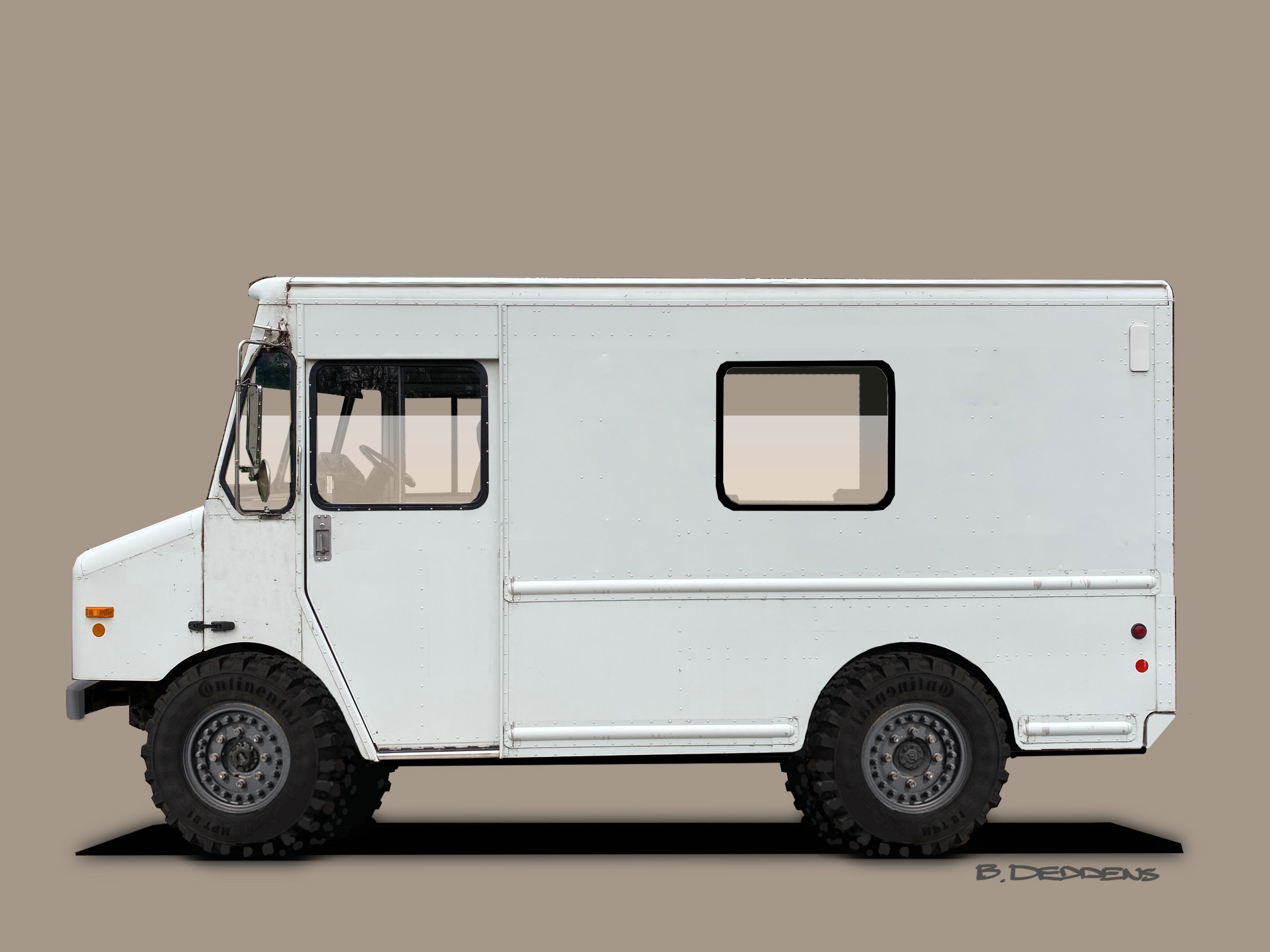

I was planning to add 20" wheels, ~40" tires, limited slip rear diff & matching 5.13 gears for the larger tires to run in in 2wd mode while saving for 4x4 components - that would get the proportions looking great like the above sketch. To complete the 4x4 conversion after that it would just be integration / transfer case & shafts.

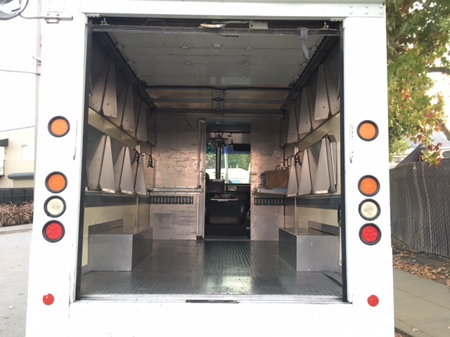

Interior
Interior is the same as when I bought it - with the super handy fold-down shelves on both sides, and bulkhead with locking door between cab and cargo areas. All doors (sides, interior bulkhead, and rear roll-up) and ignition use the same key. E-track is around the inside, and I have some brackets for 2x4s. Also, a set of interlocking EVA (black foam) mats, (in the back) cut to size for the floor, and enough to do the front. The original meritor axle is currently in the back & I have a set of axle relocation plates (From WFO concepts - to move it 1.5" forward) with angled shims if someone wants to run tires larger than ~41".

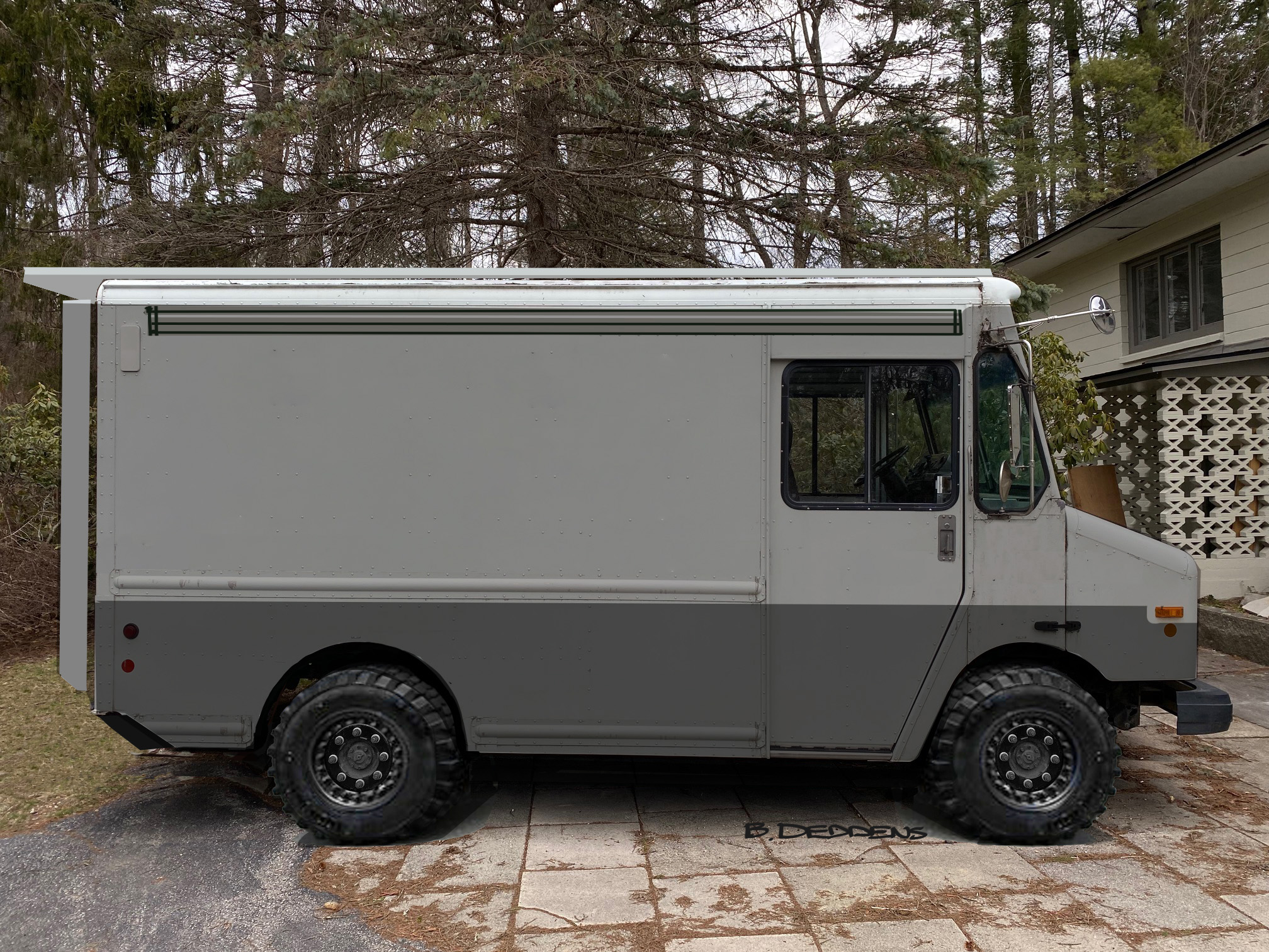

One more photoshop sketch showing MPT81 335/80r20, 41" tall tires on steel military surplus wheels with my plan to have a 15' awning on the side, snap-on style lift gate (porch) at the back, and solar roof.
