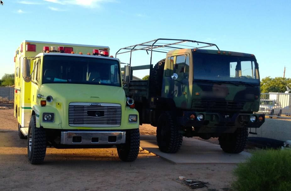

Checkout the basics
This is the only photo I have at the moment. Other photos will be taken tomorrow and some action shots on the weekend.
The moist patch under the truck is from the rain and not an oil slick. Yes it does rain in Phoenix. Too often this year. All photos are as the truck sits after driving it from LA to Phoenix and around the place to get it titled. I'm way to lazy to spruce it up for a photo shoot.
OK I am listing this for my buddy who is a bit forum challenged. He brought this only a couple of months ago to build an expo truck. But the shoulder surgery he is having will keep him from being able to get in the cab for a least a year.
And this is an example of how it could quickly be converted. Not my scene but it may suit some folks.

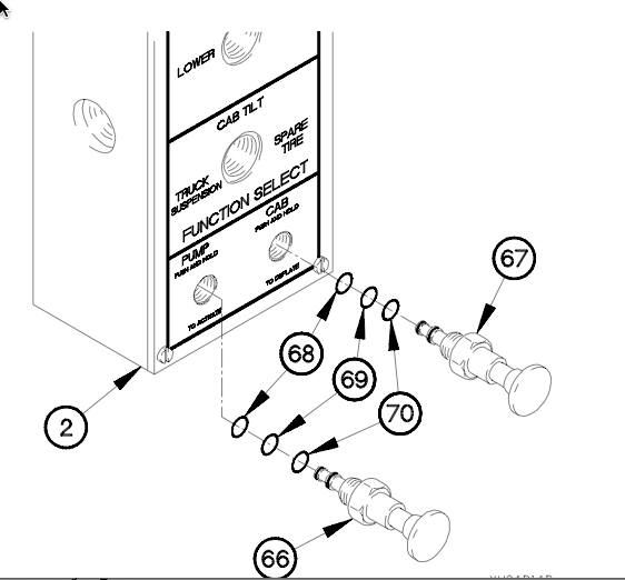

The not so good bits.
Oil leak from hydraulics for the cab/spare system. Parker control valve, probably an oring but I am not going to pull it apart to find out.

I had a bit more of a look at the hydraulic oil leak from the control panel. It is not the buttons I believed and have indicated on the prior post. It is coming from one of the control valves above. Not a constant drip but enough to be a PITA.
