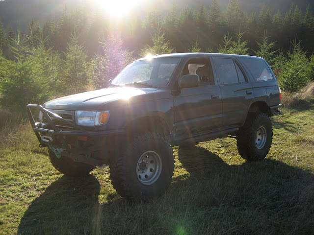

Looks like my truck.
attachment.php
Switching from 255/85's to 35's seemed to smooth out my ride. :costumed-smiley-007
