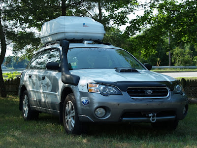

The streamlining of Superu is coming along nicely. Everything but the solar cabin vent has been removed from the roof and 100+ lbs. of weight with it (including some of the extra recovery gear in the spare wheel well).
Two week average of mpg is 31.2.
Decided to not haul the trailer on this year's trip to VT. So, the cargo box portion of the trailer will go on the roof for this trip. Wind resistance up, hassle of hauling trailer down. Will also make taking the bikes along easier as the existing Thule Parkway fold down hitch won't interfere with the trailer tongue.

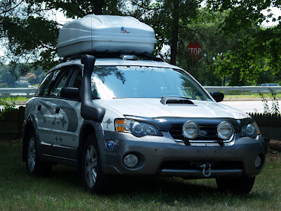

Relocated the 170's
The lights are mounted through the grill with the Surco light tabs and I drilled and cut a couple of rubber stops from the corners of some coil spring spacers I had lying around. The stops screw right up the bolts to the light fastening nut and rest against the bumper cover below to minimize vibration transfer to the lights. Seems to work rather well so far.

Relocated the 170's
