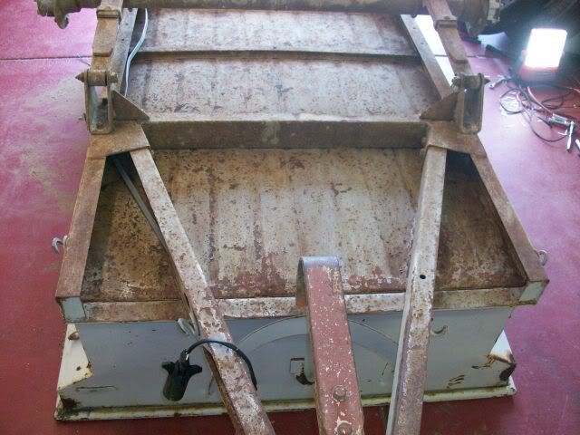

after - everything removed and the tub is almost ready for blasting. i learned that the tubs on the T3's are spot welded to the frame, not bolted on like the the M-100/M416's...so much for a frame off resto.
While removing crusty rusted bolts I had a chance to look at the frame closer and didn't locate any cracks or rusted through areas. Bolt removal required a cheater bar and some Dubya D-40. It proved to be an entertaining family affair. On the tongue is what I assume to be a tire carrier that was spot welded to the frame rail, don't think they came from the factory that way. The weld needed to be removed before I could take the draw bars off. I want to strip the trailer down to the smallest components to be thorough so the draw bars need to come off to expose the bottom of the tub.

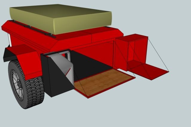

Ideas have been swimming around my head for days so I decided to put them in Sketchup so I can sleep at night. I used a model for an AT Chaser as the base and changed the paint, relocated the jerry cans, added a cooler on the tongue, a swing away kitchen box and Frontrunner water can on the rear. I think the spout on the Frontrunner is a great idea and wanted to incorporate it into the "kitchen" for easy access. I'm thinking this arrangement will allow me to utilize the tailgate as a table when the kitchen and H2O are swung out and will help balance the weight on the tongue from the Yeti Cooler.
I realize I'm getting ahead of myself but I haven't lost sight of all the work that needs to be done to get to this point. I'm thinking of trying my hand at sandblasting so if you've done it before any tips are welcome.
Concept looks good.
