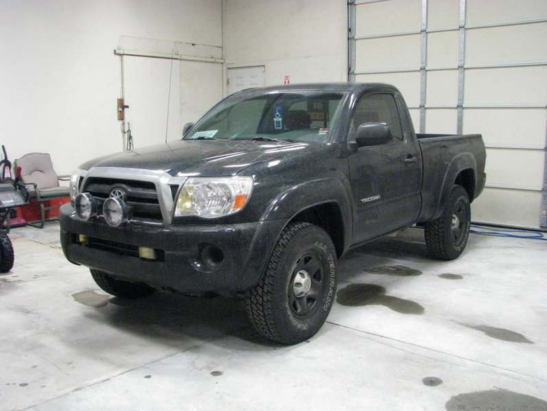

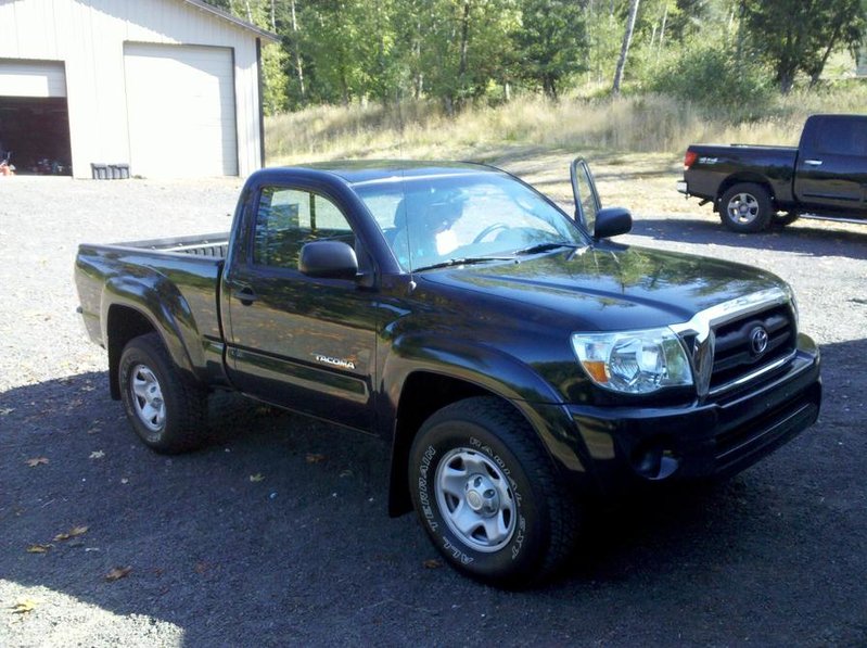

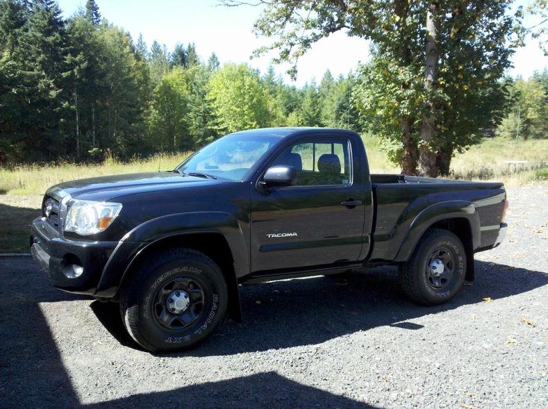

A little background I am a person with disabilities. I really messed up my back from being hit by some **************. This past August I broke my neck in a motorcycle accident. Previously to my unfortunate events I was a mechanic and certified by 7 manufacturers. Now I'm studying to become a Special Education and Secondary English teacher. Anyway, back to the handicapable incredibuild! I sold my Audi A6 and picked up a black sand pearl 2008 SR5, regular cab, 4cyl, 4x4, 5spd with 55k on the ticker.
Here she is the day I bought her! September 4 2011
attachment.php

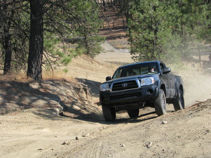

It didn't stop me from Meeting up with some other members for some light off roading at 7-mile ORV
attachment.php

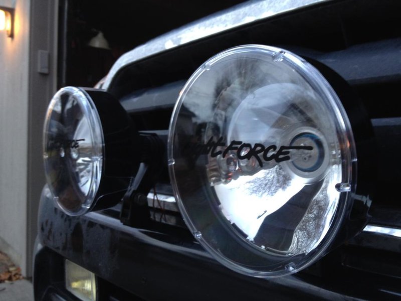

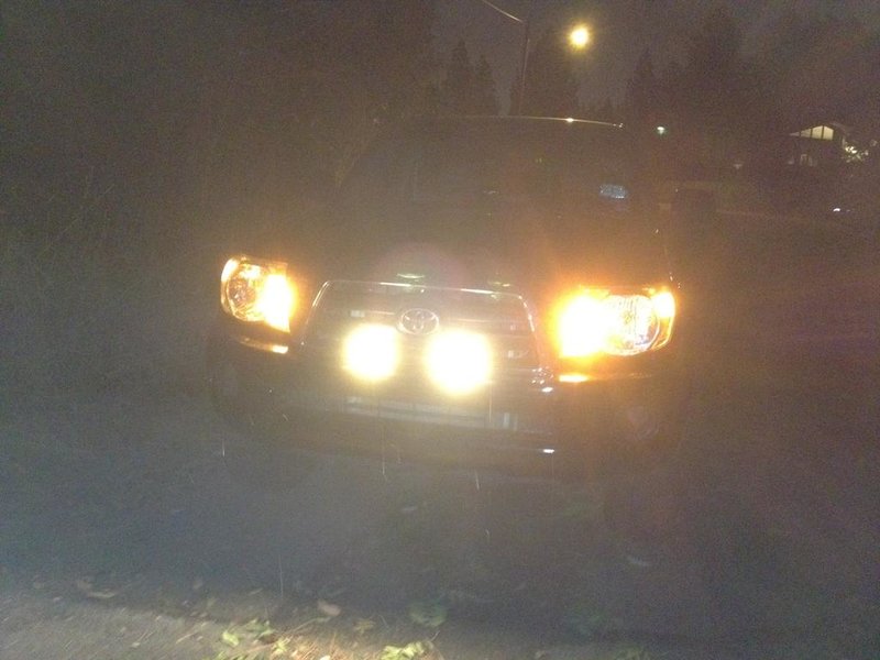

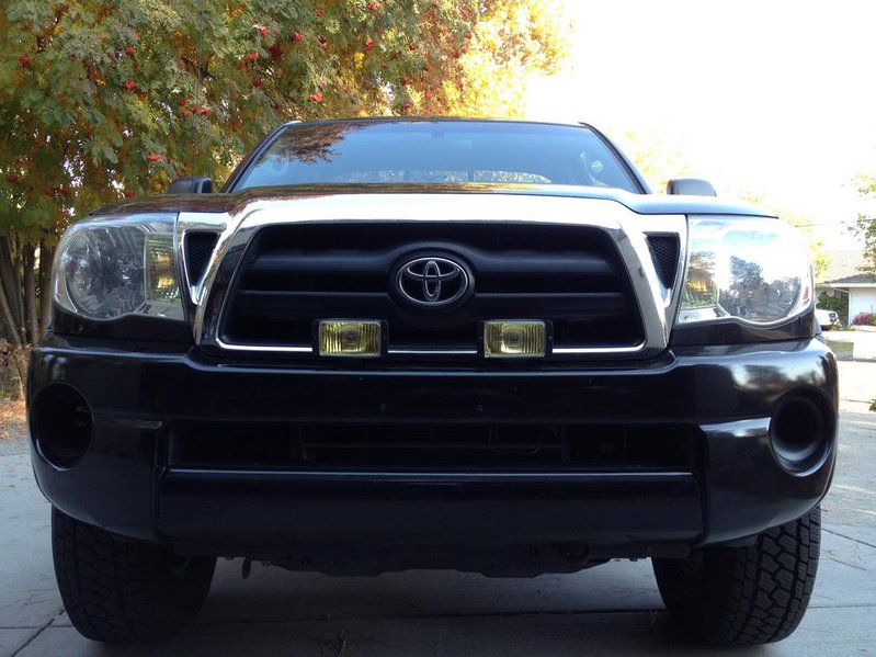

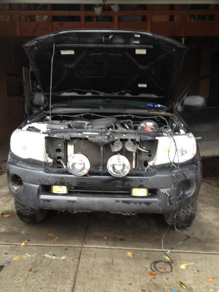

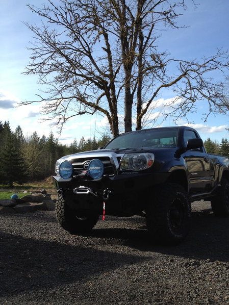

Well that just wouldn't do so I got some lightforce 170 strikers for Christmas and relocated the fogs
attachment.php
attachment.php

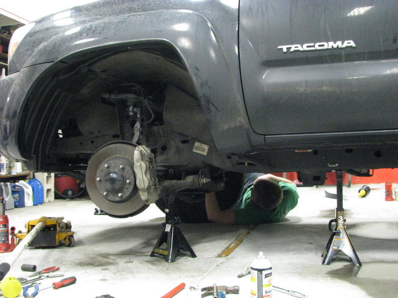

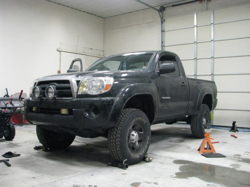

Then came the OME lift kit It was a big debate between what springs to get because the spring rates aren't designed for the regular cab. So I spent a while on the phone with ToyTech (great people by the way) and was guided to the 885x springs because I'm getting a winch and plate bumper.
here is part of the install
attachment.php
attachment.php
attachment.php
Before
attachment.php
After!
attachment.php
As she sits right now!

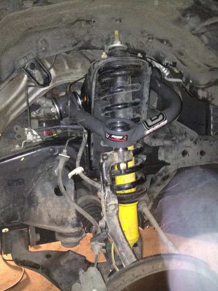

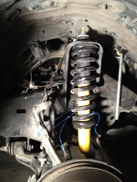

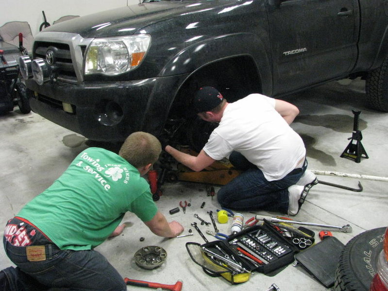

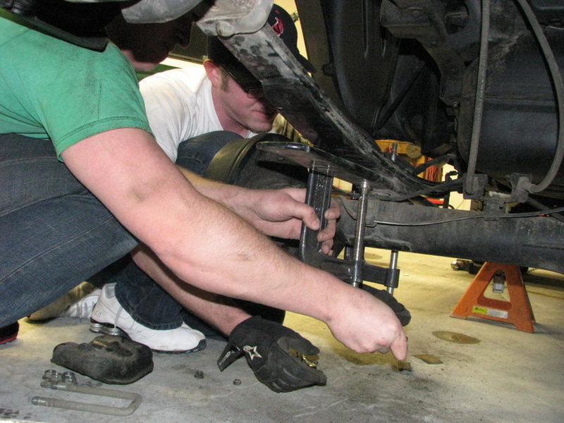

After the lift my UCAs were MAXED OUT so....
Camburg to the rescue!!
I really struggled getting these on by my self So and other member came to my rescue THANKS BRENT!
attachment.php
This is when Brent showed up to help I got stuck within 10 minutes he got the bolt in
attachment.php
Back together
attachment.php

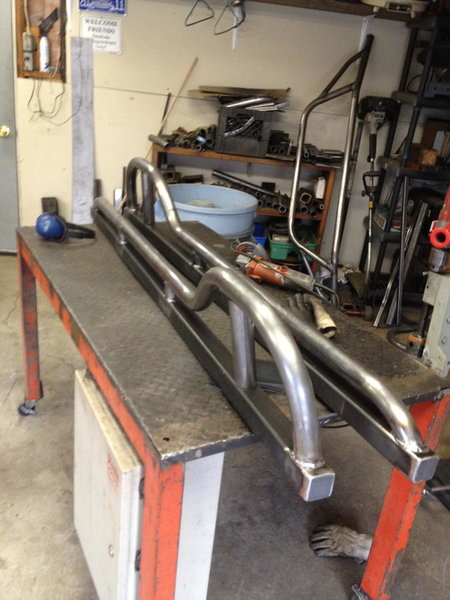

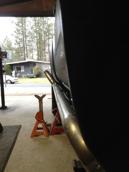

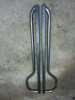

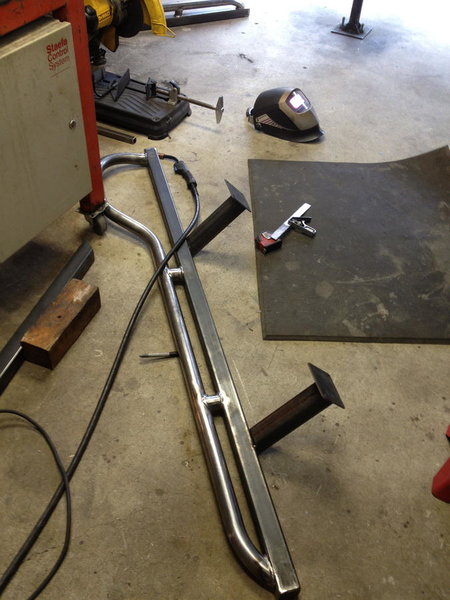

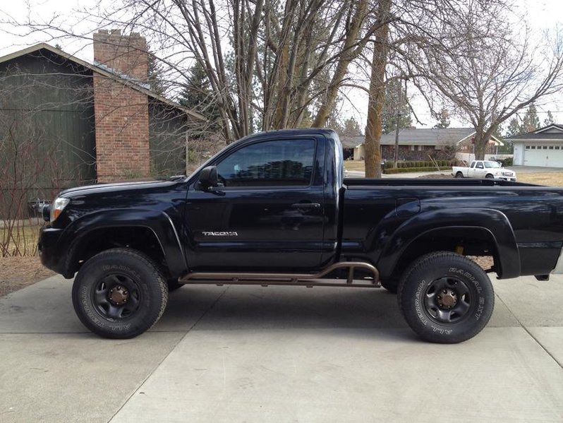

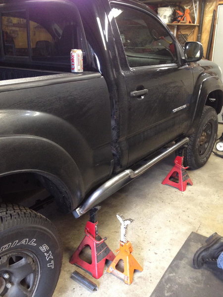

I also had some sliders made here locally they still need to be installed
It was about 15* outside while we were bending up the pipe DAMN was it cold!!
attachment.php
attachment.php
attachment.php
attachment.php
attachment.php

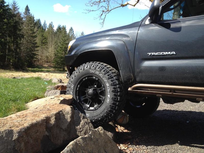

Here The sliders are after being painted the color os called Rustic Mist the iPhone camera doesn't do it justice. SO haters can be quiet until you see it in person.
attachment.php
attachment.php
attachment.php
Slider are on!
attachment.php

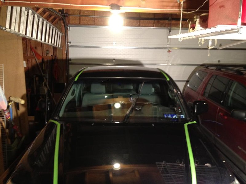

After reading numerous threads on how the guys with roof rack lights complain about the lights shining off the hood into their face I decided to flat black the hood to alleviate some of the light coming back at me.
So i wiped the hood down with 91% isopropyl alcohol and masked off the hood where i wanted to spray the derp.
attachment.php
Then i make off the rest of the truck
Let the derp begin!!
The final Product

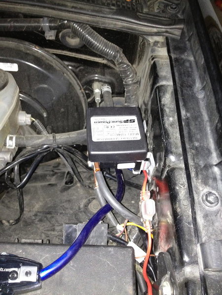

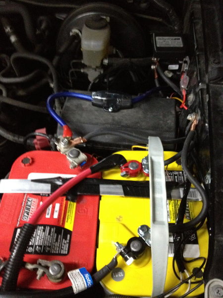

Batter Isolator!
attachment.php

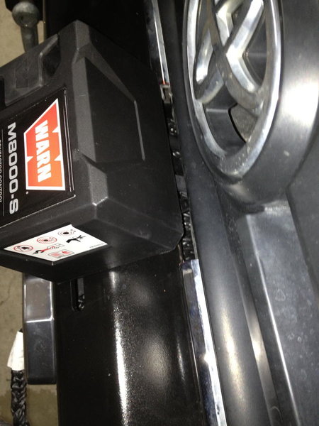

Winch wires up and both batteries, everything works perfectly
attachment.php
Had to cut part of the grill to get the cables behind the grill and to the battery and winch.
attachment.php
Finally all back together and the cable on the winch
attachment.php

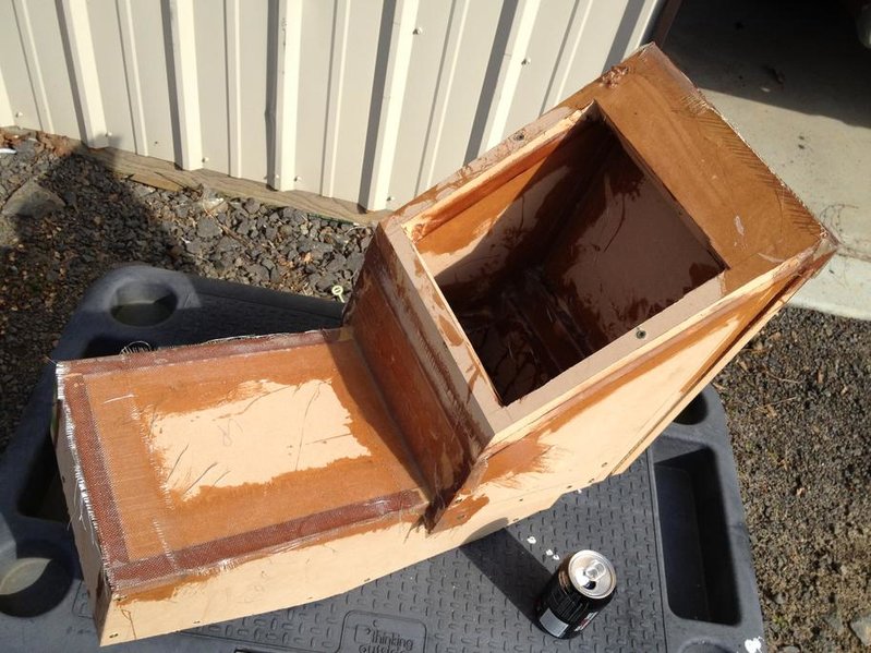

UP NEXT DUAL BATTERY SET UP AND SUV BOX
Twistedfreedom

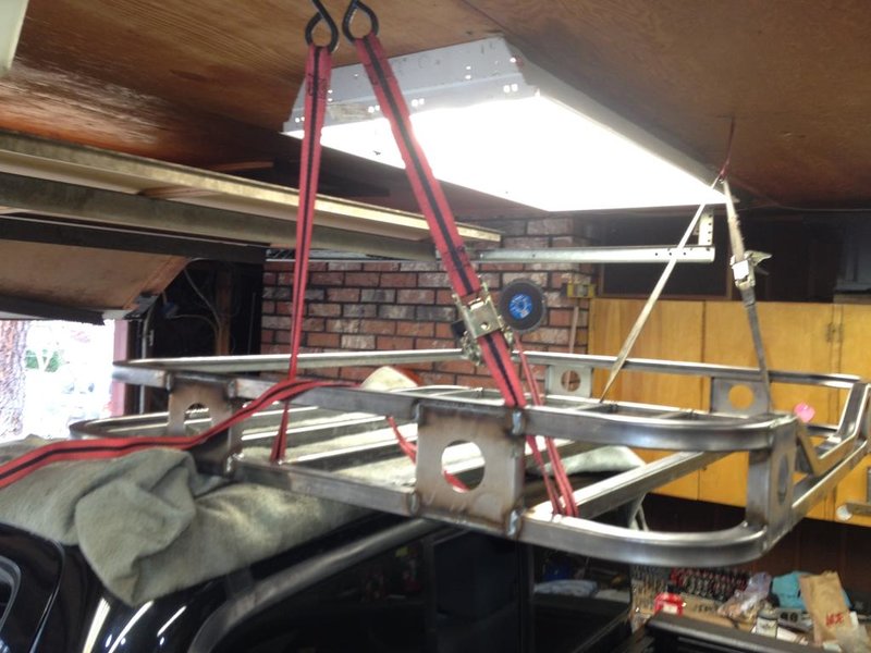

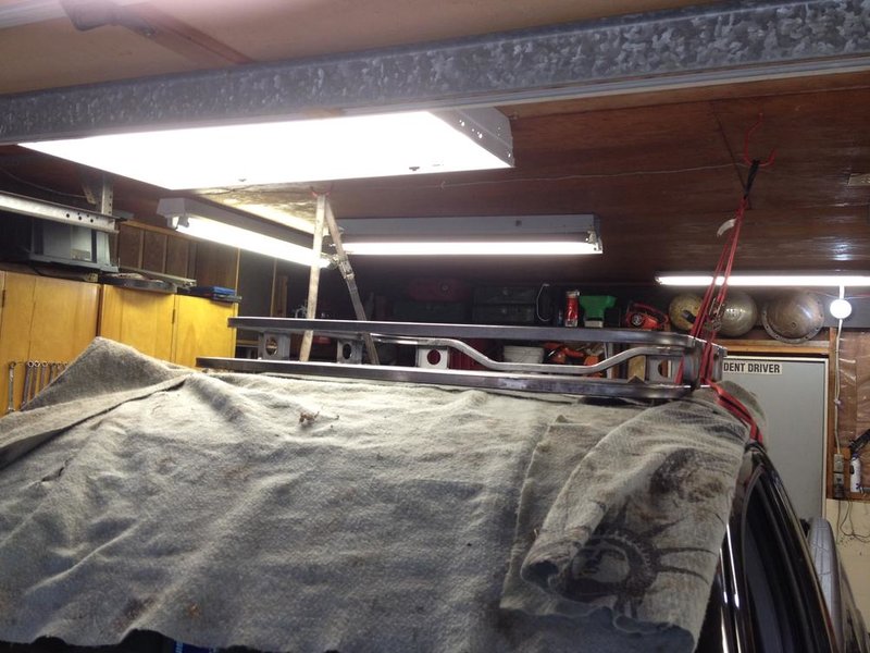

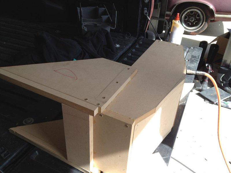

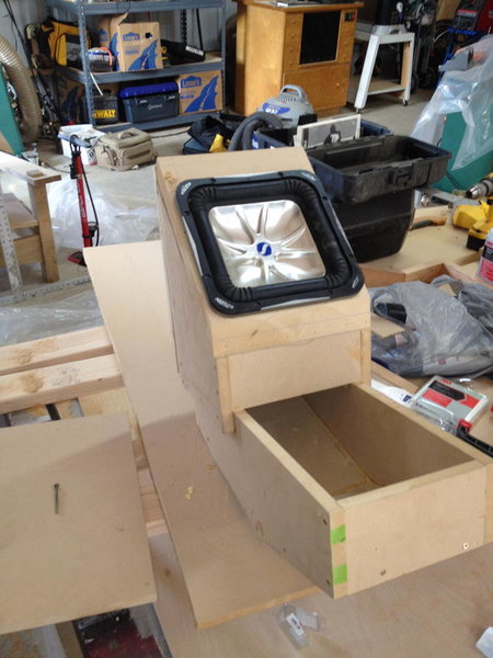

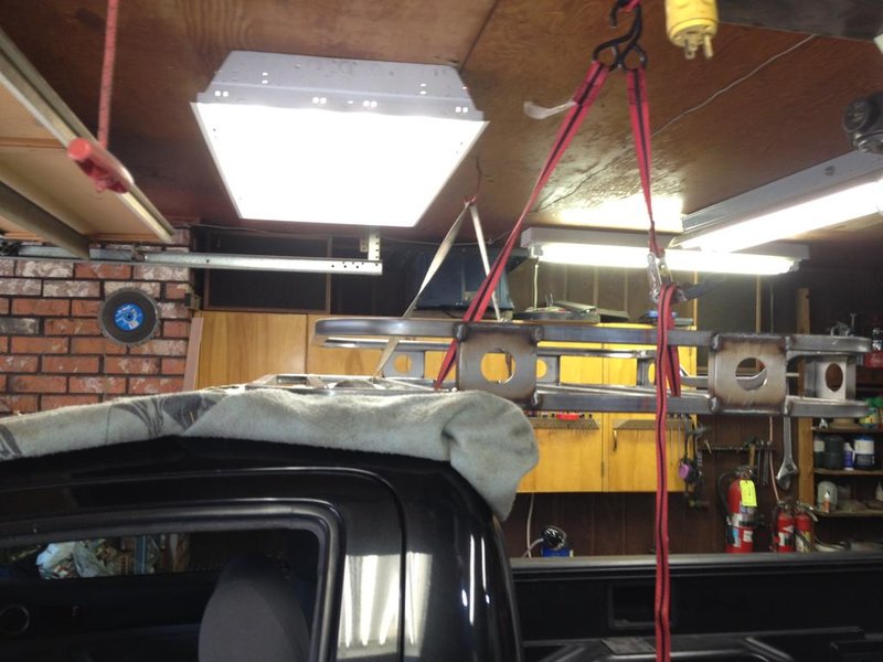

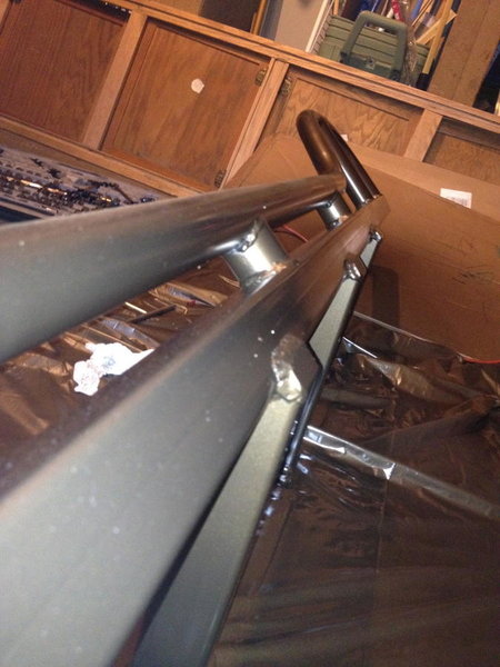

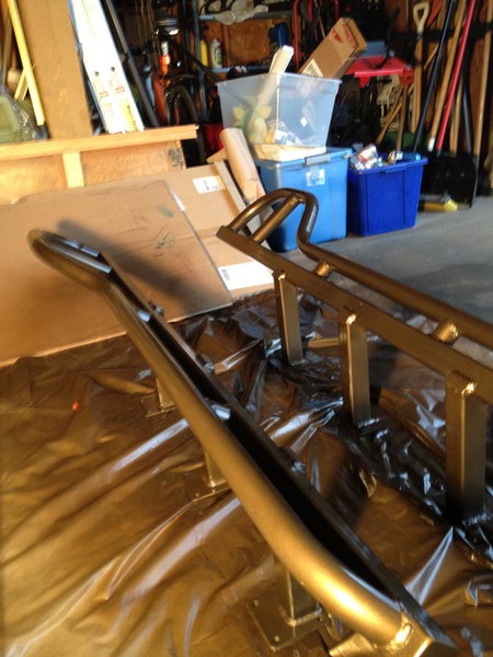

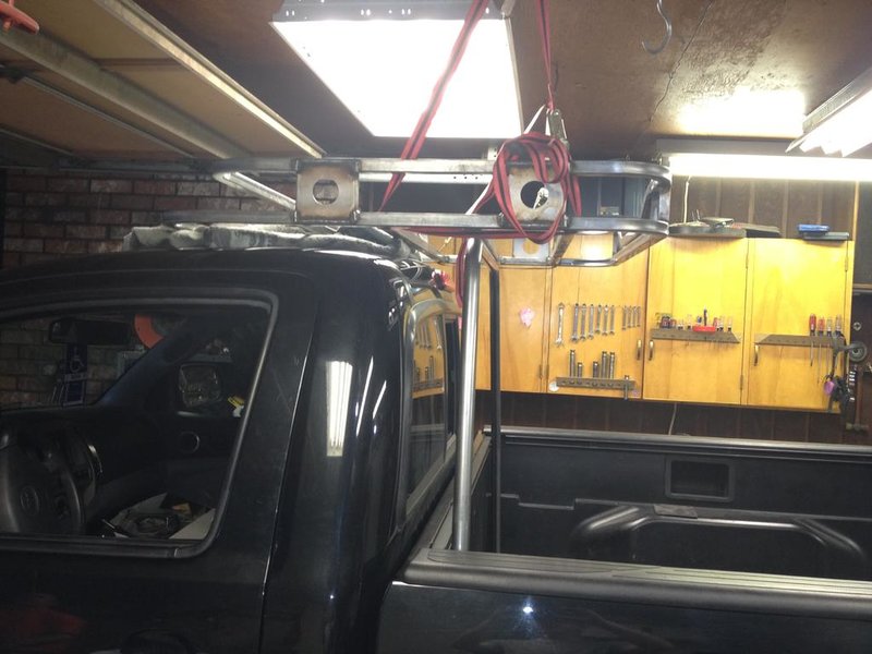

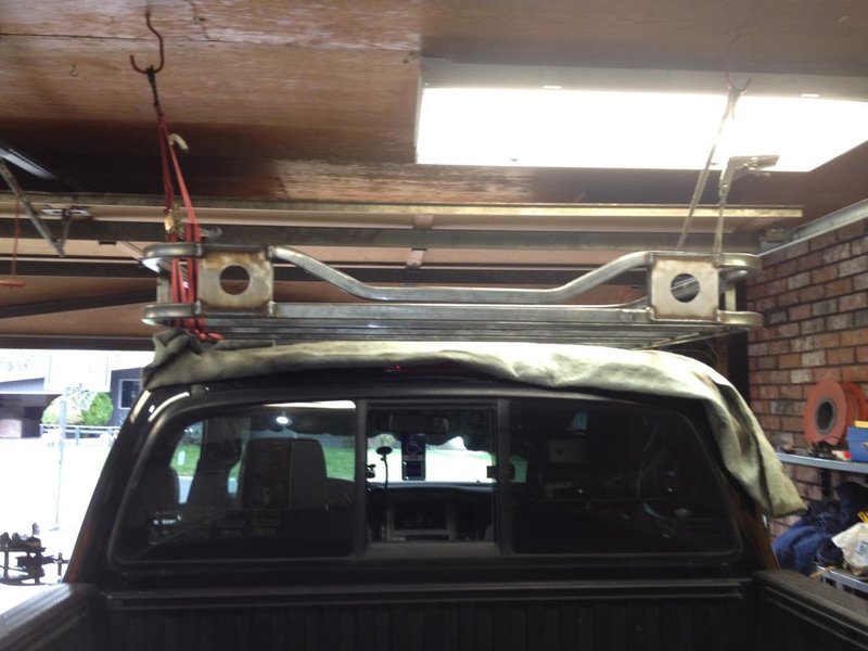

Here are some more teaser pictures.
I have everything ready to go just need to make the final welds and drill the holes in the bed for the rear support legs.
attachment.php
attachment.php
attachment.php
attachment.php
attachment.php
attachment.php
john101477
Photographer in the Wild
Pretty cool build so far Twisted. Nice touch on the Kicker and the Boston audio. They both used to make some amazing stuff in my day and I am sure they have not stopped. I think I would have rounded off the edges of the enclosure but thats just me being picky. Looking forward to seeing how you finish off the rack as everything else is coming together very nice!

hahah great rig man, I love everything you have done to it. About those sliders though, you have a paint code by chance? They are sick!
