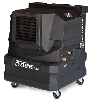

Swamp coolers do work but only under conditions of low humidity. They remove heat energy from air by using it to evaporate water, making the air cooler but more humid. This could be one reason the carpet in the above example refused to dry. Example of how this matters: a factory I worked in for awhile in Colorado had these swamp coolers:
and they worked great to keep things comfortable even in the 90s. Same company opened a facility in Arkansas and installed the same swamp coolers. They actually made things worse by raising the humidity which was already very high. Instead of the forced air absorbing the water like it did in Colorado, it just blew water around. In a dry climate the swamp coolers were a godsend but in a humid environment, they were evil. The floor was wet, tools rusted, mold grew...it was awful. To say nothing of the fact that the air was muggy and did not cool off at all. In dry climates a swamp cooler can make a room cooler and more comfortable. In humid climates they do not cool the room but they actually make it less comfortable. The human body regulates its temperature the same way swamp coolers work. We sweat and the sweat evaporates, cooling our bodies. Humid air can't dry the sweat because it's already saturated with moisture so we are less comfortable and warmer. Air conditioning makes us more comfortable because the discharged air is cooler AND dryer. A swamp cooler can make us more comfortable if the discharged air is cooler (possible only if the air is already dry) but in the process it's also made more humid. If you'll be in a dry area and stay there, swamp coolers can work. If you'll be moving around, I'd not waste the time, $, and energy on one.
IMO swamp coolers CAN work, under the right conditions. Air conditioners DO work, under all conditions.
