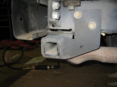

For those that tow with a TJ or LJ and have an aftermarket bumper with hitch built in, do you tow with that (the bumper receiver) or do you prefer the stoutness of a true receiver hitch that bolts under the frame, like one from Valley, Draw-Tite or similar?
I'm running a Rockhard4x4 rear bumper, it has built in hitch, though the depth of the receiver (the hole where you slide the ball mount in to) is shallow and I would have to track down a special ball mount to work with this bumper since there is very little length to it after the pin hole for securing it to the receiver if I were to use it as the hitch.
see pic below to understand what I'm referring to, but nevermind the fact that this isn't a ball mount, but a recovery shackle... you will see that there's less than 1" after the pin hole
BUT, most aftermarket bumpers don't technically give their hitches a "load rating", because of liability issues I presume.....and they probably don't have the resources to put them through their paces to test them and all that jazz...
I'm thinking I'd be better off using a true frame mounted purpose built receiver hitch for towing what little a TJ can tow as opposed to using the bumper's receiver hitch, which has no tow rating..... right now I have no trailer. loosing a bit of clearance at the rear (departure angle) is of no consequence at this point as I have no intentions of doing nasty rock crawling.

I do have the frame tie-ins on my Rockhard4x4 bumper, they look like this:
but I am using all three bolt locations on the side plates.
Problem I am having with regard to finding a receiver hitch (still up in the air about doing that or using what I have - the bumper) is some of the hitches wrap up around the frame and use some of the bolt holes taken by the frame-tie ins... of course, I don't know which brand hitches do or don't , or maybe they all do - don't know yet since the info in catalogs or online isn't specific about that.

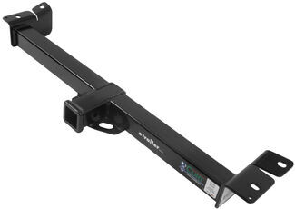

orangeTJ
I rethought the idea of towing with the bumper and realized to do so, with the current trailers I have (which aren't offroad models) I'd need a drop hitch of 8" or so, which is a bit excessive. Also required, would be to cut the tail off the hitch, so there was no more than about 1" of metal left behind the hole for the pin that secures it to the receiver.
And I already have enought ballmounts in my collection, and one with a large drop would only see limited use.
I started looking for a hitch again, and in very short order I FOUND ONE!!! (one that bolts exclusively below the frame and doesn't use the holes on the side, which are used up by my frame tie-ins)
It's made by Curt Manufacturing, It's the model 13408.
I've ordered stuff from etrailer.com before, and they have free shipping if you order over $150.00.
http://www.etrailer.com/mm5/merchant.mvc?screen=PROD&Store_Code=E&Product_Code=13408
