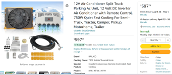

Very nice. Can you share a little more on the AC? Type, shore power, lithium setup for off grid, etc. Thank You
Roscoe Reporter
The AC is a 5K unit. Pretty cheap, from Lowe's, on special for like $139.00. I am not going to be running this unit off the 206 Ah LiFoPo4 battery I have, but will run it off a power pedestal or a generator in a pinch. If you are intending to use an AC off grid, with batteries, then a 12V unit would be the way to go. They make semi truck units for around $600 with a split unit system. I will be putting the unit on a slide and sliding it part way out an access door while operating. Hope this helps.
