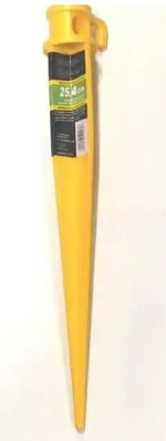

These are what we use in the loose sand in our desert camping areas:
10" plastic stakes with with a tapered "cross" feature gives them good purchase in sand. $3.50 each at home depot.
As you've found, there is no "one perfect" stake - different conditions require different options, so I carry some of the Home Depot stakes, but also some of the fancier steel ones that are easier to drive/retrieve and hold well in firm earth.
Those tree stakes look really good!
