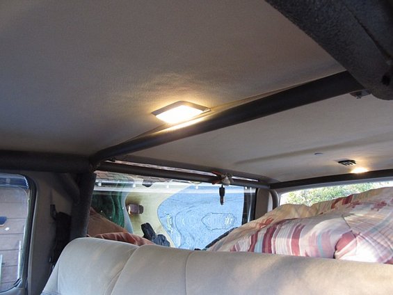

Too much glare, none are the proper color (white, not bluish-white).
Edit:
I take that back, I do have LED dome lights, but I converted them myself because (again) I couldn't find any decent conversion bulbs/units that weren't some cold bluish color.
