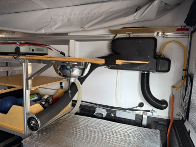

It is vented right out the side of the topper. A hole is cut in the side of the composite/aluminum wall and the intake/exhaust is run right out the wall. The propane hookup is also run through the wall so the tank is outside. I just have mine sitting on the ground but you can also attach a mount on the topper and have the tank mounted there as well. In this picture you can see the round vent and also the propane connection.

3) Truma sells just about nothing in the US for DIY. I had a really hard time sourcing the interior ducting I wanted to add under the sink in the picture. Couldn’t buy it on line or directly from Truma CS. Not the standard size for diesel heaters, etc (it’s 80mm). Even a Camping World here I talked to couldn’t source it in the US for some reason, and they are an official Truma dealer. Mario at AT took pity on me a sold me a meter.
