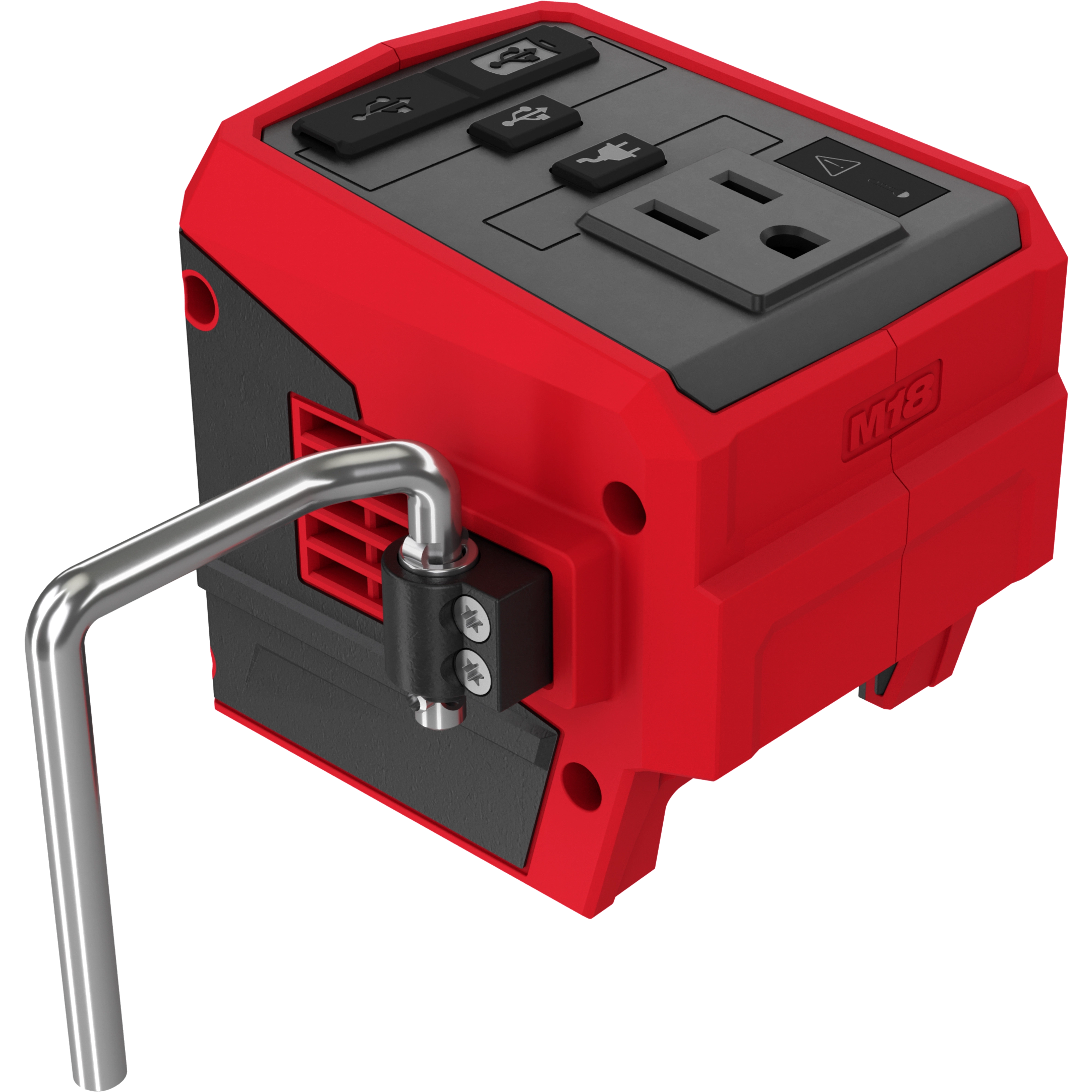

I do not have an answer to your question, just sharing my solution to the same problem, which is to use the Milwaukee Top-Off power supply. Somewhat more versatile than a wired charger since you can charge away from the truck. But you will also need M18 batteries and a M18 car charger for a complete solution. Other power tool manufacturers probably offer comparable inverter power supplies.

The Milwaukee thing is cool but also only puts out 45w on USB C which probably wouldn’t be able to keep up with my laptop.
